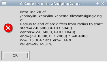

I did the upgrade but now I get always a radius error.
I get this error also with g-code files which were perfect under the old version.

What do you mean by "Radius Error"?
Can you give the exact error message?

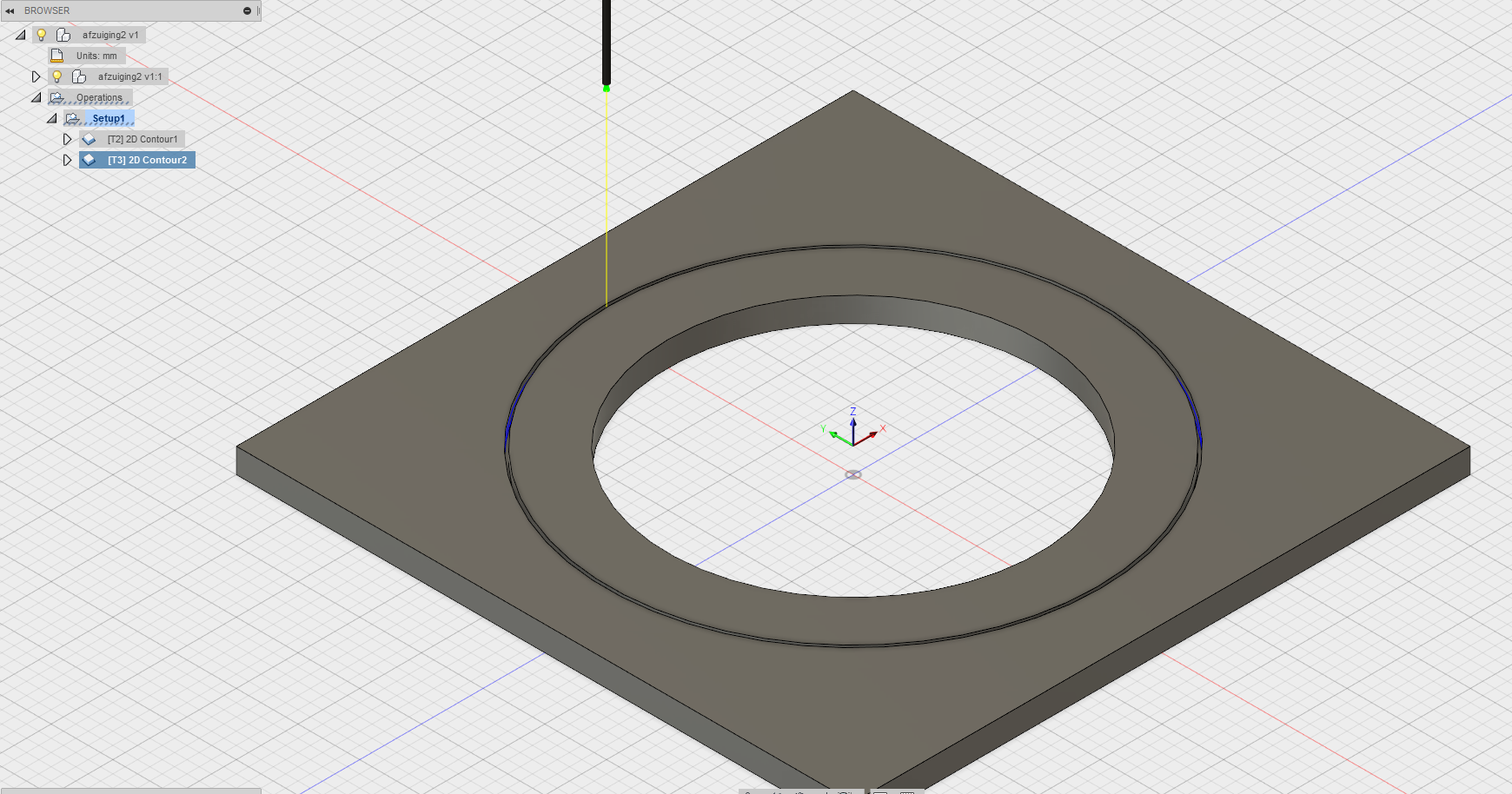

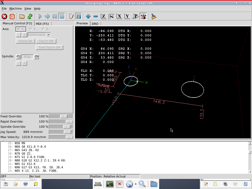

Attaced you'll find a screenshot from the error screen.
Also included a screenshot from Linuxcnc. the 2 paths are not concetric.
but in the fusion 360 drawing these paths are concentric.
I never had this kind of problems with the older version of linuxcnc.

19 Jun 2016 06:04 #76280 by andypugh
Replied by andypugh on topic problems after upgrade form 2.6.x to 2.7.4
At a guess this is because the arc-centre settings have changed from G90.1 to G91.1 or vice-versa.
What do you see in the "Active G-codes" on the MDI tab? Which is Fusion expecting to use?
Has Fusion inserted a G91.1 in the G-code?
I know that the Autodesk G-code editor application preview is _completely_ messed up by G91.1

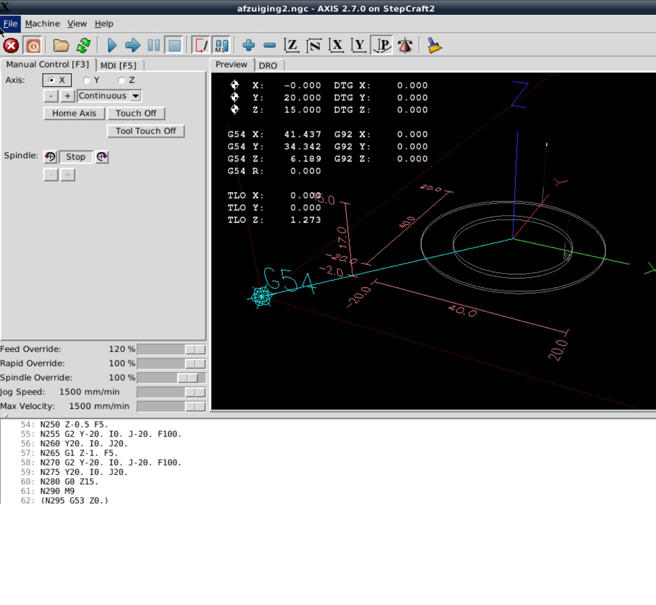

26 Jun 2016 06:09 #76671 by JoFr
I did install on an other pc the version 2.7.0 and loaded the same file.
Here is everything perfect and it runs without warnings.
