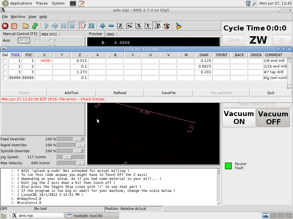

problems after upgrade form 2.6.x to 2.7.4
- Posts: 19904
27 Jun 2016 11:05 #76717
You can check by using the tool table editor, or by looking at the tool.tbl file with a text editor.
Replied by andypugh on topic problems after upgrade form 2.6.x to 2.7.4
What do you mean with x offset, how can I check it?
