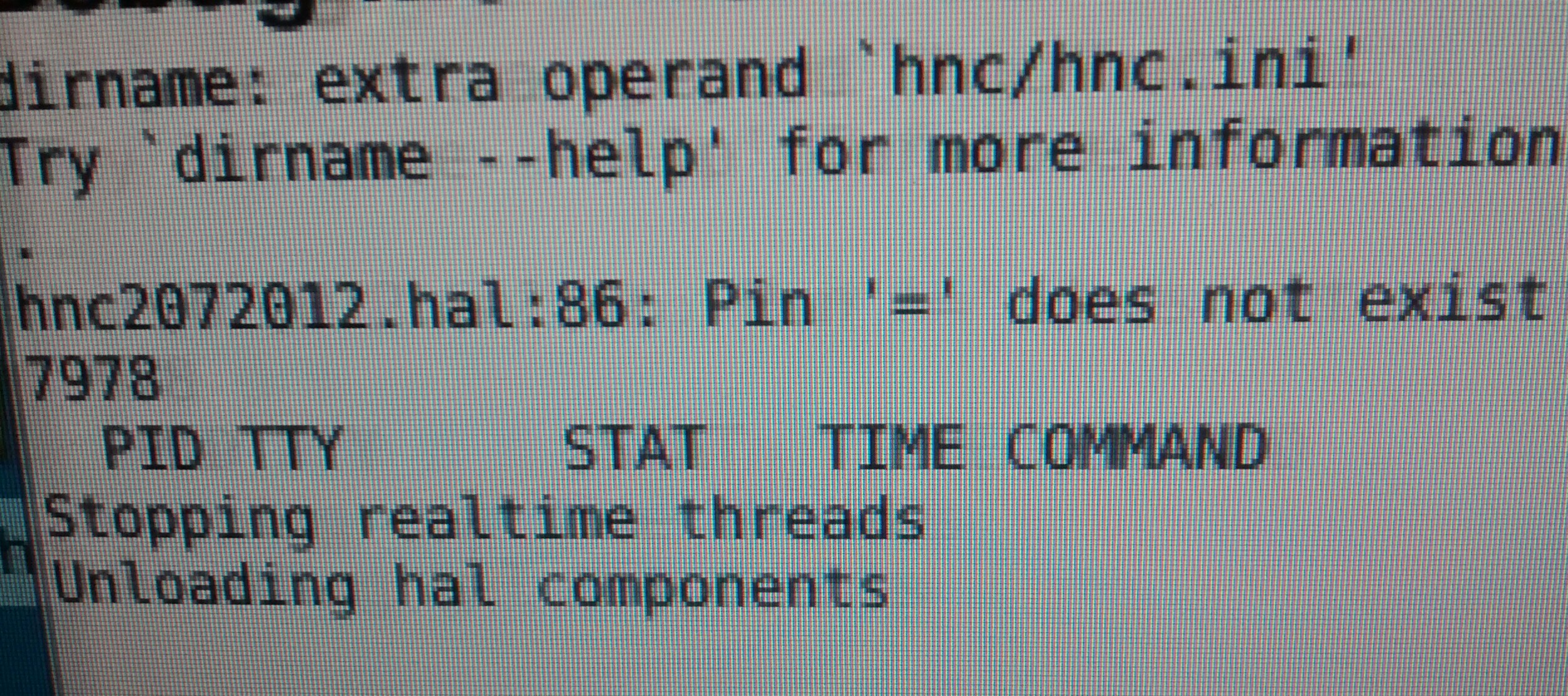

Snafu with Hal, upgrading from 2.4.6 to 2.6. was created by JR1050
[attachment:1]IMG_20160630_233833.jpg[/attachment
After a fresh install on a new hd and load of lcnc 2.6.2( i think), I compiled my components and went to run lcnc only to get the message.
I don't use the <= or => in my Hal file, as they supposedly don't make a difference and I find them confusing, any way, as soon as lcnc sees an = with out the pointer , it throws this error. If I add a pointer , problem goes away until the next = . I can change them all to having a pointer. Any one have any idea what is causing this? Thanks
I can attach the Hal file if it will help

Replied by cmorley on topic Snafu with Hal, upgrading from 2.4.6 to 2.6.
From the source code commit:
halcmd: Better detection of some arrow-related typos
This fixes a confusing result where the command
net name firstpin <=secondpin => thirdpin
(note the missing space) would connect firstpin and thirdpin, but leave
secondpin unconnected, and would not give an error.
With this change, only the three expected arrows: =>, <=, <=> (see man halcmd)
are accepted, and only if they are a separate word that matches exactly; this
causes the net command above to fail with:
Pin '<=secondpin' does not exist
This will fail unexpected arrows like ===> that were previously accepted but
never documented as accepted.
