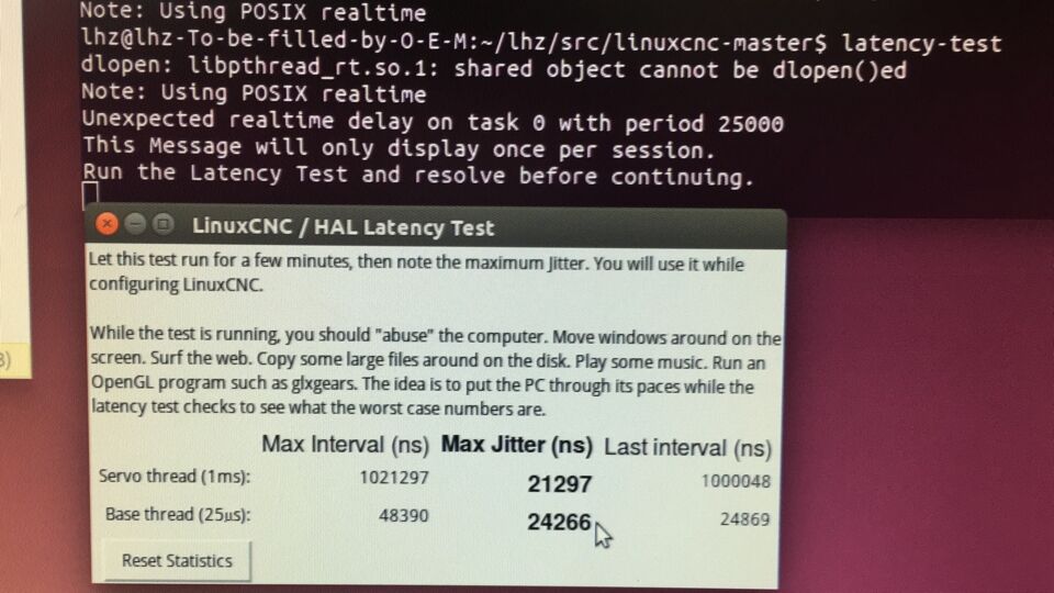

But when I tpye ". ./scripts/rip-environment" and run latency-test to test the realtime performance(without linuxcnc running), the resault is not good.
So I wonder if the linuxcnc has not been installed with xenomai successfully.
So when you execute the debian configure command, did you set the argument as "xenomai"? If you did, and is there any message just like mine "your kernel xenomai" is not known, ***"?

20 Dec 2018 20:35 #122671
by shameless
Replied by shameless on topic LinuxCNC on Xenomai
When I run the test , there's "USING POSIX Realtime"
I attached the photo below, when it run for a while, the reault will be much worse and worse.
Especially for the Base thread, the performance is bad at the running start. It print "Unexpected realtime delay on task 0 with 25000,***"

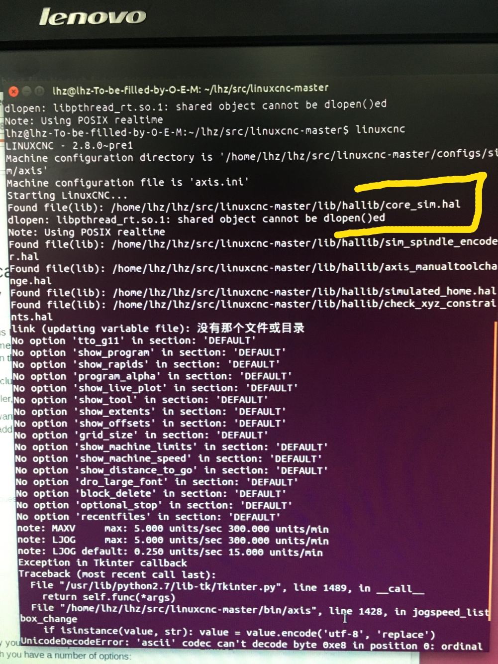

When I start LinuxCNC for the command line, after I choose "axis", and there are lots of prints, including "Note:USING POSIX Realtime",And I atteched it below.

21 Dec 2018 04:19 #122681
Replied by andypugh on topic LinuxCNC on Xenomai
A jitter of 25,000 is perfectly usable.
What hardware do you anticipate using?

21 Dec 2018 07:59 #122697
by shameless
Yeah, CPU is Intel i7
I solve the "dlopen:**" problem.
And it print "Uing Xenomai(posix skin) realtime.
Now the performance is around 25,000
and now I am install linuxcnc-ethercat
but I can not even "make" it, it prints "configure.mk.8: *** halcompile/comp executable not found or set, terminated"
Oh, why are there so many many many problems?
