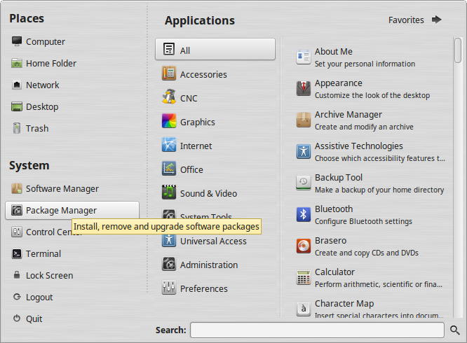

NOTE: Go into package manager and remove ndiswrapper and virtual box. If these are not installed then don't worry about it, at worse case during the build process you get warnings and will not break the build if you elect to not removed these packages.

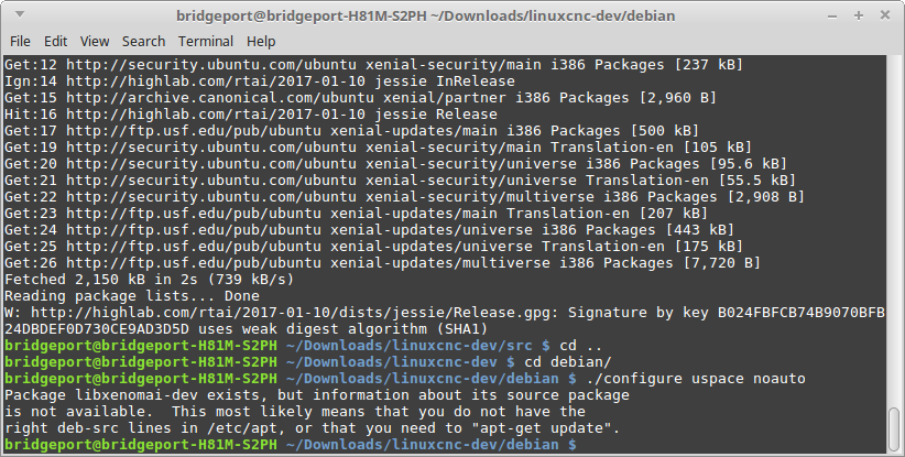

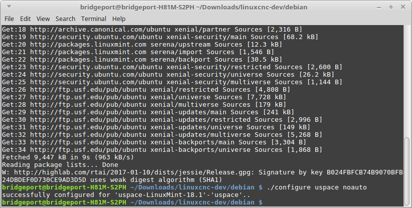

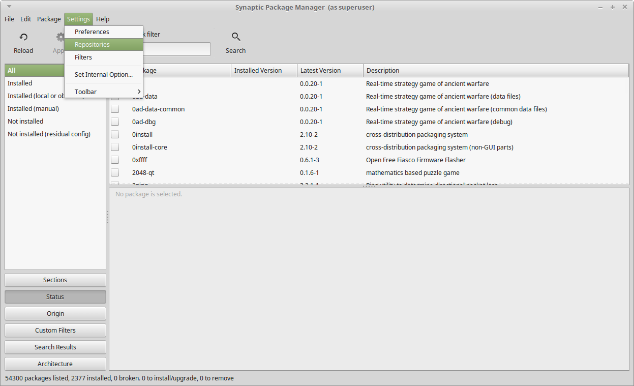

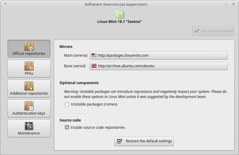

NOTE: You need to enable source repositories and apt-get update for the next steps using ./configure uspace. If you do not you will not be able to complete this step. Package Manager>Settings>Repositories> Check Mark - Enable Source Code Repositories.
NOTE: If you miss the step of [sudo apt-get update] and on a fresh install it is possible that apt does not know you have enabled the source code repositories and will fail complaining you may need to update apt.
sudo apt-get update
cd linuxcnc-dev
cd debian
./configure uspace
cd ..
dpkg-checkbuilddeps

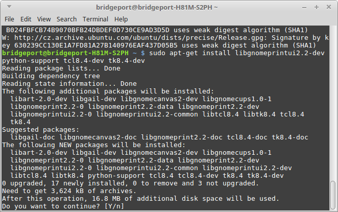

Commonly reported dependency:
dpkg-checkbuilddeps: error: Unmet build dependencies: libgnomeprintui2.2-dev python-support tcl8.4-dev tk8.4-dev
To fix the issue above please issue this code:
sudo add-apt-repository 'deb http://mirrors.kernel.org/ubuntu precise main universe'
sudo apt-get update
sudo apt-get install libgnomeprintui2.2-dev python-support tcl8.4-dev tk8.4-dev
Install whatever it is complaining about using the “sudo apt-get install package_name”.
HERE is a EXAMPLE of source code repositories not being enabled or not doing an apt-get update:

./configure uspace
This is what you are looking for SUCCESS!!:
--Checking build dependencies

NOTE: Commonly reported dependency:
sudo apt-get update

28 Jan 2017 12:50 #86850 by Rolquin
This is a great tutorial, there is a lot of information here. Thanks for sharing.
I have not been complete this step: Package Manager>Settings>Repositories> Check Mark - Enable Source Code Repositories.
For some reason the check mark option is not active in synaptic manager.
Is there any way to get this option active ?
Thanks.

28 Jan 2017 14:04 #86855 by rodw
I think you are looking in Synaptic, not Package Manager. Remember that everything in Linux is configured via text files and Package Manager and Synaptic are GUI interfaces to allow you to edit the relevant text files with less pain.. These 2 programs kind of overlap and there are others as well.

28 Jan 2017 14:06 - 28 Jan 2017 14:33 #86856 by cncnoob1979
Rolquin,
Is package manager asking you for your su password when you open it?
You should have a screen like so:
EDIT: sorry I said synaptic; meant synaptic package manager in my response.
