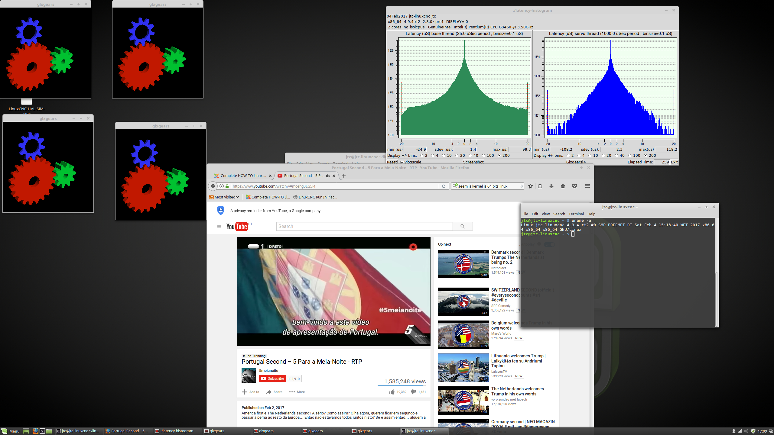

04 Feb 2017 11:27 - 04 Feb 2017 11:28 #87300
by jtc
Replied by jtc on topic Complete HOW-TO Linux Mint 18.1 32/64 RTAI or PREEMPT with RIP install or deb
Today I have time to test this tutorial, work great
I'm using linux mint 18.1 cinnamon 64bit
I'm with a 2560x1440 resolution on on board graphics(msi h97m-e35). the latency could be better but at least I can get a decent resolution.
Two minor bugs for now, Axis starts minimized, and no shortcut for linuxcnc on the start menu, next time I compile linux I will "make install menus" and see if it solves this.
João
João
Last edit: 04 Feb 2017 11:28 by jtc.
- cncnoob1979
- Posts: 403
- Thank you received: 75
04 Feb 2017 11:39 #87302
by cncnoob1979
Replied by cncnoob1979 on topic Complete HOW-TO Linux Mint 18.1 32/64 RTAI or PREEMPT with RIP install or deb
There is a fix for the menus issue. If you read at the bottom of the post it tells you how to get the menu to show.
Glad you found the tutorial helpful!
Thanks!
Thanks!
