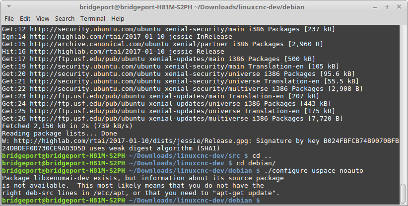

Just tried the noauto switch
Without the source code repository enabled you will still get the same error as mentioned above.

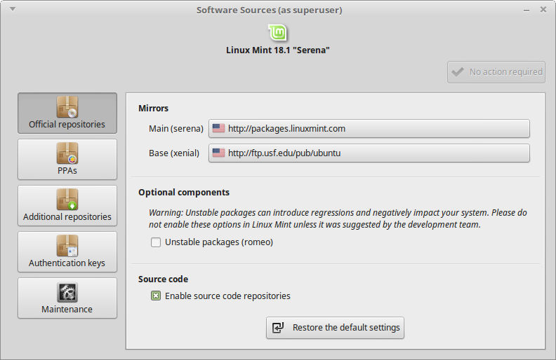

So for the configuration to execute you will still need to put a check mark in package manager to enable source code repositories. Then you can configure how you would want.
Ill have to build linuxcnc and see how it goes with the noauto switch. But as you can see you must enable sourcecode repositories to have the configure script execute.
bridgeport@bridgeport-H81M-S2PH ~/Downloads/linuxcnc-dev/debian $ ./configure uspace noauto
Package libxenomai-dev exists, but information about its source package
is not available. This most likely means that you do not have the
right deb-src lines in /etc/apt, or that you need to "apt-get update".Without the source code repository enabled you will still get the same error as mentioned above.

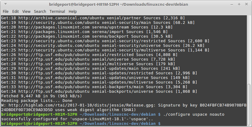

successfully configured for 'uspace-LinuxMint-18.1'-'uspace'..
bridgeport@bridgeport-H81M-S2PH ~/Downloads/linuxcnc-dev/debian $ Ill have to build linuxcnc and see how it goes with the noauto switch. But as you can see you must enable sourcecode repositories to have the configure script execute.

Thanks for the quick answers, I'll try again in the morning and update my notes. Just to be sure I installed Mint 18.1 again and will start from scratch in the morning.

Ok, got the kernel build and LinxcCNC deb built and installed and getting some decent latency on this crummy motherboard with uspace.
Linux mint18-1 4.9.20-rt16 #1 SMP PREEMPT RT Sun Apr 16 12:21:04 CDT 2017 x86_64 x86_64 x86_64 GNU/Linux
Thanks for the tip about enable sources.
JT
