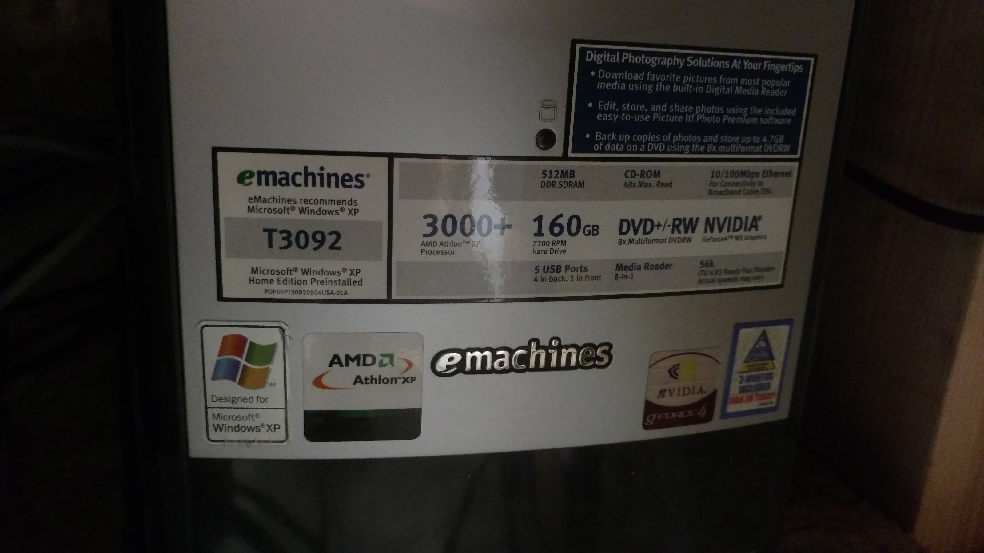

21 Apr 2017 06:20 #91771
by beltramidave
Replied by beltramidave on topic Time to update. I think..
Hi Todd
I have attached a pic showing my computer specs. It is about 8 years old but has been working fine other than the real-time error on startup of LinuxCNC. Latency was around 20k.
I am using a Dell monitor, the same one as before reinstalling LinuxCNC 2.5. the issues that I am having is that the bottom toolbar is mostly off the screen and mouse clicks have to be above an icon to work. Max resolution should be 1280x1024, but can on get 1024x760.
I am going from memory as I am not home now until Monday.
Any help would be appreciated. Thanks

Does the machine still only have 512MB ram? That is kind of scraping the bottom for what might work with the newer OS. If you really want to update to the latest OS (Linuxcnc's Debian Wheezy ISO) Then a hardware update may be called for.

Checked on RAM and I did upgrade to 2gb.Does the machine still only have 512MB ram? That is kind of scraping the bottom for what might work with the newer OS. If you really want to update to the latest OS (Linuxcnc's Debian Wheezy ISO) Then a hardware update may be called for.
