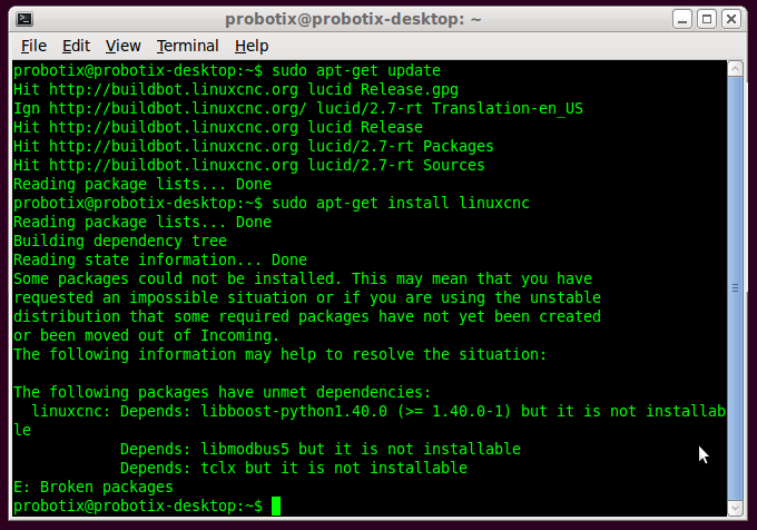

Followed the directions the best I could. Did not have " /etc/apt/sources.list.d/linuxcnc-buildbot.list:", so I added:
deb buildbot.linuxcnc.org/ lucid 2.7-rt
deb-src buildbot.linuxcnc.org/ lucid 2.7-rt
to the Software Sources - Other software page.
Then I did the sudo update and install. Update went well, but got unmet dependencies on install. I attached a screenshot.
Thanks for all of the help, so far!!

Replied by Todd Zuercher on topic Time to update. I think..
Is "deb linuxcnc.org lucid base" in your source list? That should take care of that dependency problem. If you removed or disabled that one it would cause that problem.

No, is that the exact wording that I need? The only things in my source list are the 2 items from the buildbot site (in the above post).
I think maybe it didn't copy and paste right, the website turned it into a link.
deb http://linuxcnc.org lucid basePlease Log in or Create an account to join the conversation.

Thanks Todd. That help get rid of one of the dependencies. I had to do more searching for libboost-python and tclx, but I did finally get them and have 2.7.8 installed with Lucid 10.04. Yea!!
Now back to my original problem, which was my screen resolution. Anybody have some ideas for me on that? Monitor capable of 1280x1024, but max resolution in monitor set up is 1024x760.
