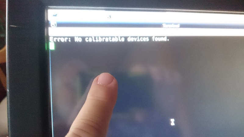

So here I am back again with another PC with EloTouchScreen.

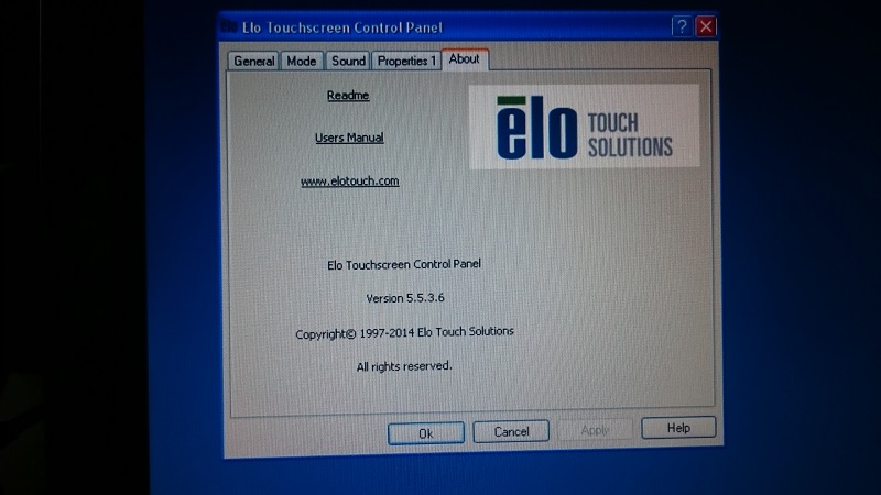

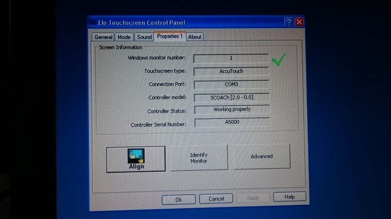

1. Works like a champ in Win XP
TouchScreen is there and connected to COM3 and is working just fine.

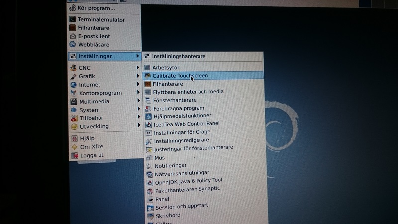

2. Calibrator installed
But NoGo as usual, why is it so hard to get peripherals working?
Any pointers on what is missing as it can not be found obviously.

Several hours of headbanging I found a usable command = screen /dev/ttyS?
?= set to 2 I got some action from the touch so now it is working OK.
wiki.ubuntu.com/Touchscreen it is here I found the above command.
I used this wiki.linuxcnc.org/cgi-bin/wiki.pl?Debian_Wheezy but it did not get me to the goal.
deb package downloaded from this link www.freedesktop.org/wiki/Software/xinput_calibrator/

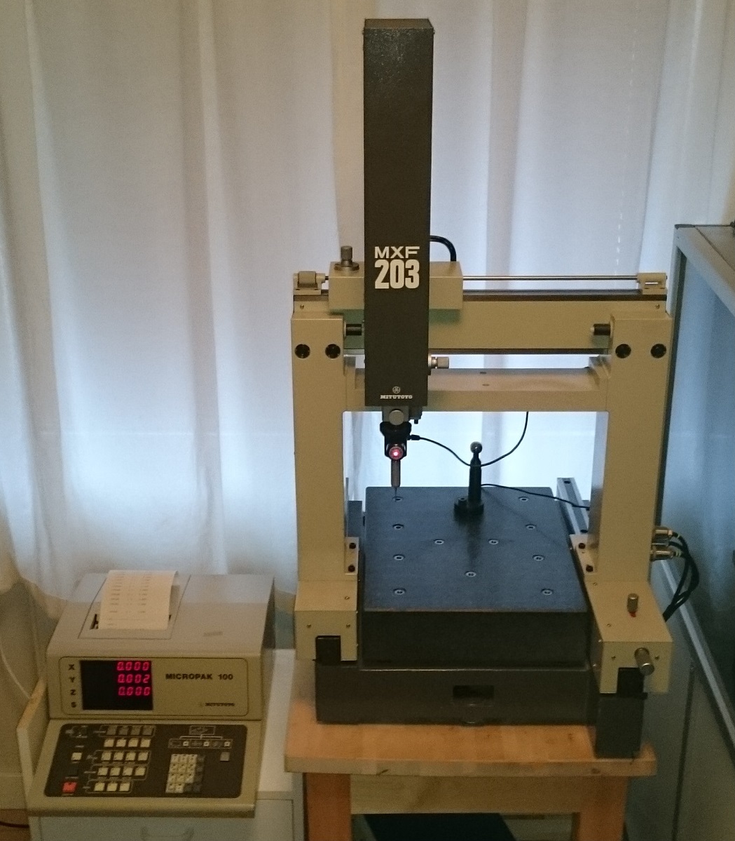

So I am back on track with this PC for the manual Mitutoyo CMM to automated.

I have an ELOtouch monitor installed and the touch screen has been automatically sensed. The calibration is scaled wrong horizontally, and seems reversed vertically,.
I installed xinput_calibrator per your link. Thanks for that.
When run, xinput_calibrator errors out with a missing dependancy "libgtkmm-2.4.so.1"
I tried "sudo apt-get install --reinstall libgtkmm-2.4-1v5" which I found through google for a similar error, but this returns:
Reading package lists... Done
Building dependency tree
Reading state information... Done
E: Unable to locate package libgtkmm-2.4-1v5
E: Couldn't find any package by regex 'libgtkmm-2.4-1v5'
the I tried just doing an install sudo apt-get install libgtkmm-2.4-1v5
I also tried changing the file name to "...2.4.so.1" and just doing an install...
Same failure.
I would appreciate some assistance in getting xinput_calibrator running please.
