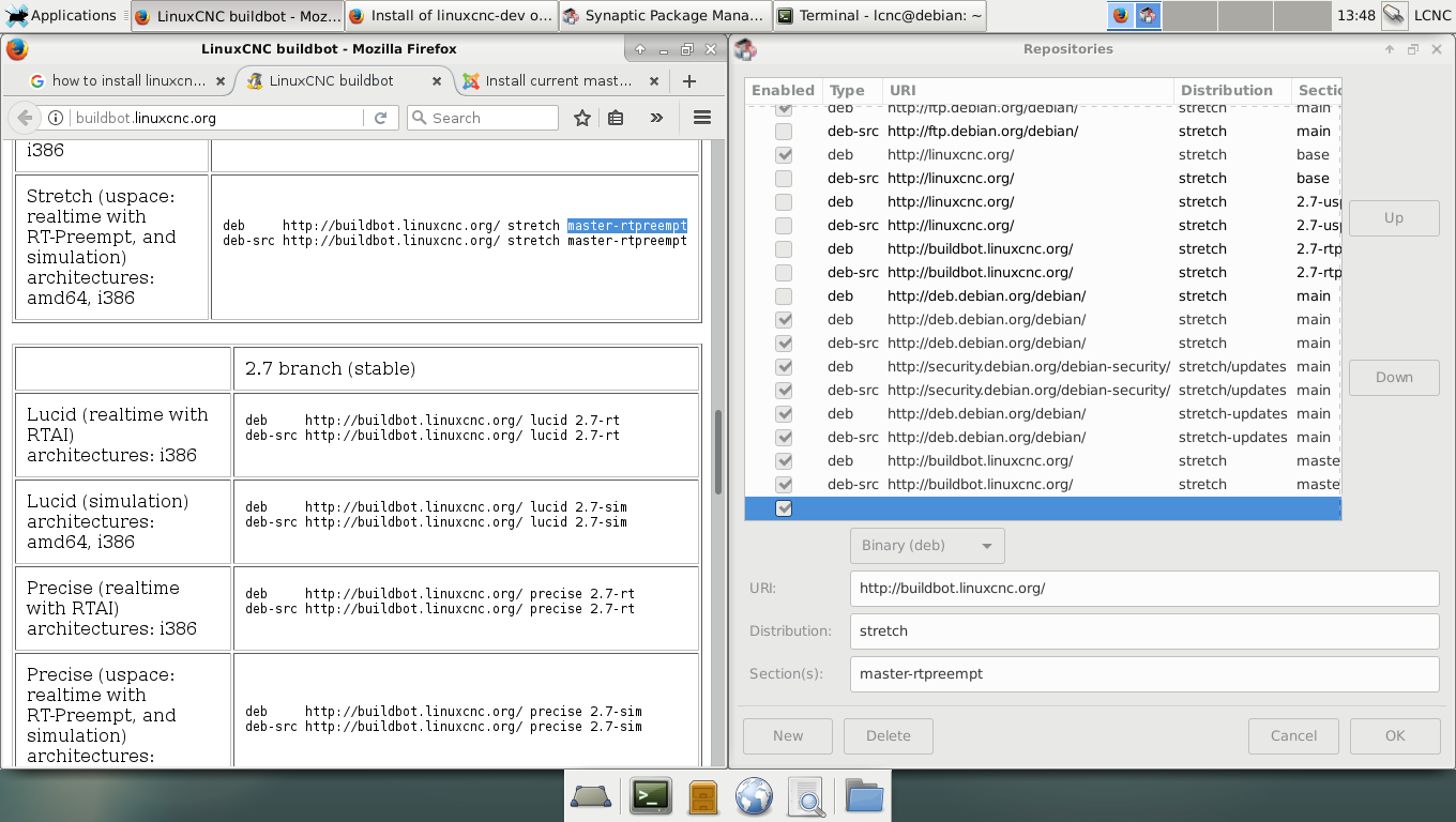

20 Nov 2017 10:47 #102066
Replied by andypugh on topic Install of linuxcnc-dev on debian stretch. Can't do install. Run-in-place works.
You don't need to do any of that. You can just install 2.8 as a package from the buildbot.
buildbot.linuxcnc.org/

31 Aug 2018 03:28 #116901
by yrsiddhapura
Replied by yrsiddhapura on topic Install of linuxcnc-dev on debian stretch. Can't do install. Run-in-place works.
how i updated LCNC 2.7 to 2.8
i had also tried a lot and facing same problem its little different then wheezy in stretch
way i had done is i had used synaptic package manager -> Settings -> Repositories -> New -> and then i had divided whole link as shown in image for both binary and source and then pressed ok and then return to synaptic package manager and press' apply' and its updated packages and installed new one after that process its done.
