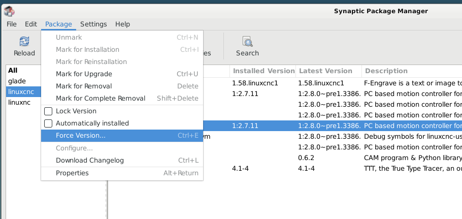

Replied by cmorley on topic Downgrade Glade
I propose you use wheezy deb I believe it will work.
I am sure I used it for mint 13.2 - ( based on ubuntu 1604.
I also found this:
superuser.com/questions/998991/glade-for...work-in-ubuntu-15-10
at the bottom seems to confirm what we want.
but before we do that - in synaptics did you look for glade-gtk2?
I would have thought the iso would have had the libraries available.
Chris M

- Posts: 19904
11 Dec 2017 17:27 #102953
Replied by andypugh on topic Downgrade Glade
- Mike_Eitel
- Posts: 1051
- Thank you received: 183
12 Dec 2017 00:49 #102977
by Mike_Eitel
Replied by Mike_Eitel on topic Downgrade Glade
Thx Andy
That sounds promissing. Never remarked that option.
Mike
Mike
- Posts: 7368
- Thank you received: 2181
12 Dec 2017 01:23 #102979
if you are still talking about glade, forcing versions is not what you want to do.
Chris M
