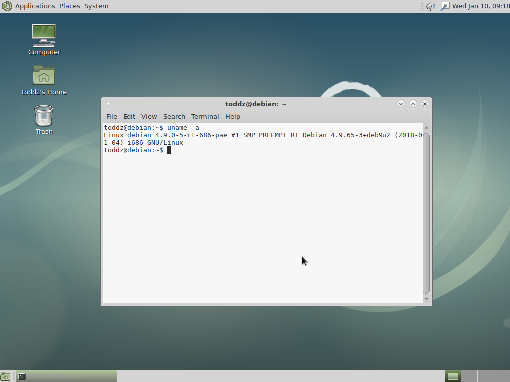

10 Jan 2018 05:42 - 10 Jan 2018 05:45 #104232
by BigJohnT
I installed Debian i386 Mate then did and update.
I went to packages.debian.org/stretch/linux-image-rt-686-pae and don't see how to get the deb. I clicked on the dep: linux-image-4.9.0-5-rt-686-pae link but got "Internal Server Error
The server encountered an internal error or misconfiguration and was unable to complete your request.
Please contact the server administrator at This email address is being protected from spambots. You need JavaScript enabled to view it. to inform them of the time this error occurred, and the actions you performed just before this error.
More information about this error may be available in the server error log."
Following the manual I got this error
"sudo apt-get install linux-image-rt-686-pae
[sudo] password for emc:
Reading package lists... Done
Building dependency tree
Reading state information... Done
E: Unable to locate package linux-image-rt-686-pae
JT
Replied by BigJohnT on topic Debian Uspace
packages.debian.org/stretch/linux-image-rt-amd64
or
JT

- Todd Zuercher
- Posts: 4794
- Thank you received: 1482
10 Jan 2018 08:31 #104238
Replied by Todd Zuercher on topic Debian Uspace

- Todd Zuercher
- Posts: 4794
10 Jan 2018 09:50 #104245
Then I installed Linuxcnc and that seemed to work without a hitch. Once I got the Linuxcnc repositories set up and the keys installed. (I did have a little trouble installing the keys.)

11 Jan 2018 06:35 #104286
by BigJohnT
Todd, thanks for the help. Took a while to get the LinuxCNC deb added to the Synaptic Package Manager, they changed the interface and now it's a two step ordeal to get one added. They don't have add-app-repository anymore lol. Anyway the net install did have the rt kernel so I'm up and going with that.
