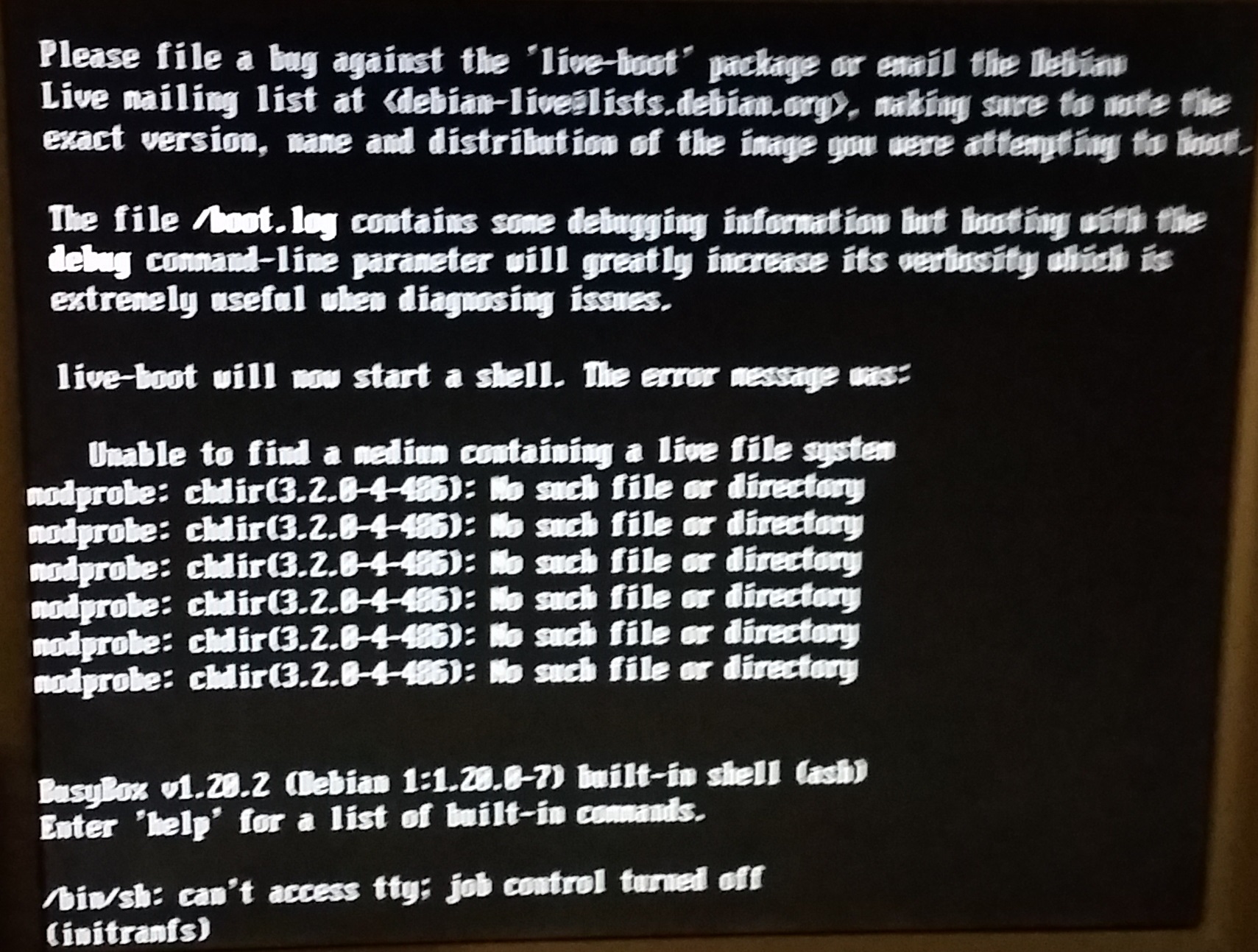

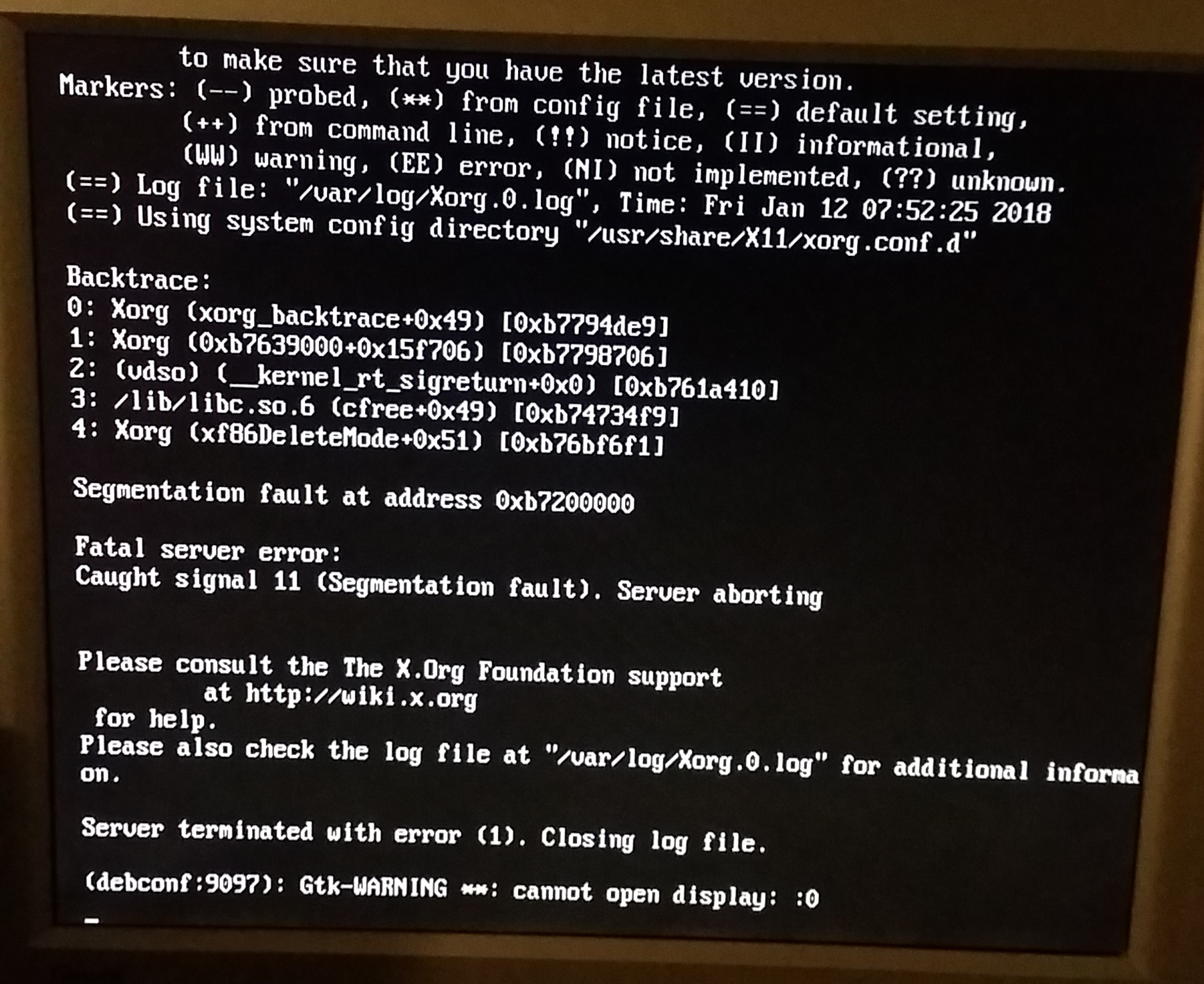

Hello,
I'm a newbie trying to use the Debian Wheezy image with LinuxCNC. I got the image on a USB using Unetbootin, but attempting to either run live or install fails with the following error messages (the first parts are cut off as they flash by very quickly).
The live fails with:
The install fails with:
What am I doing wrong? Thank you.

- anvoice
- Posts: 7
12 Jan 2018 14:49 #104358
by anvoice
Replied by anvoice on topic Debian Wheezy image won't work
Yes, apparently they no longer allow sharing with a free account... I've attached the errors in this post.

- ozzyrob
- Visitor
12 Jan 2018 18:40 - 12 Jan 2018 18:43 #104378
by ozzyrob
Replied by ozzyrob on topic Debian Wheezy image won't work
Unetbooting has issues with hybrid iso files (such as debian). This has been an issue for a while with debian images. Yes this tool is fine for some other distros.
This is the tool you want, this tool produces a result as what you would get using the dd utility in Linux.
sourceforge.net/projects/win32diskimager/
It will write a raw image to a usb stick, which is the way you want to go.

- anvoice
- Posts: 7
13 Jan 2018 03:15 #104387
by anvoice
I think you're right, must have been a Unebootin issue. I used diskimager and successfully got to the installation screen. I'm having a hdd issue right now so I won't complete the installation yet, but I'm on the way. Thanks a bunch for your help!
