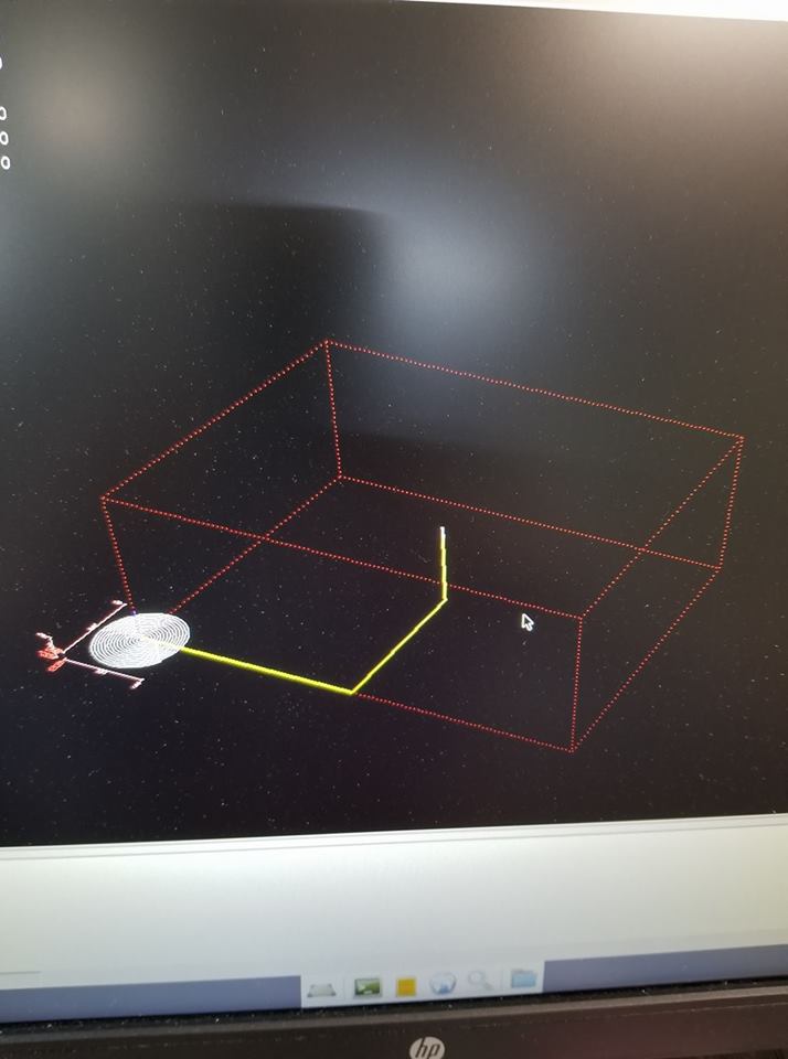

How do you center the image you wish to cut within the "box" on the screen. I have an NGC image loaded and it is showing mostly out of the "box"... ?

The box represents the overall travels of your machine in machine coordinates. I'm guessing 0,0,0 is located at the lower left of your box. You can jog to the center of your box and if you are using the axis interface, manual control tab (f3) then hit the touch off button for the selected axis and enter 0.(do this for x and y and z top of your part) this sets your g54 work coordinate system to 0 relative to the machine coordinate system. Your pocket should now be in the center. If you are actually cutting something, make sure you understand your g code and where you are starting with the z so you are not cutting into a vice/ fixture or table.
