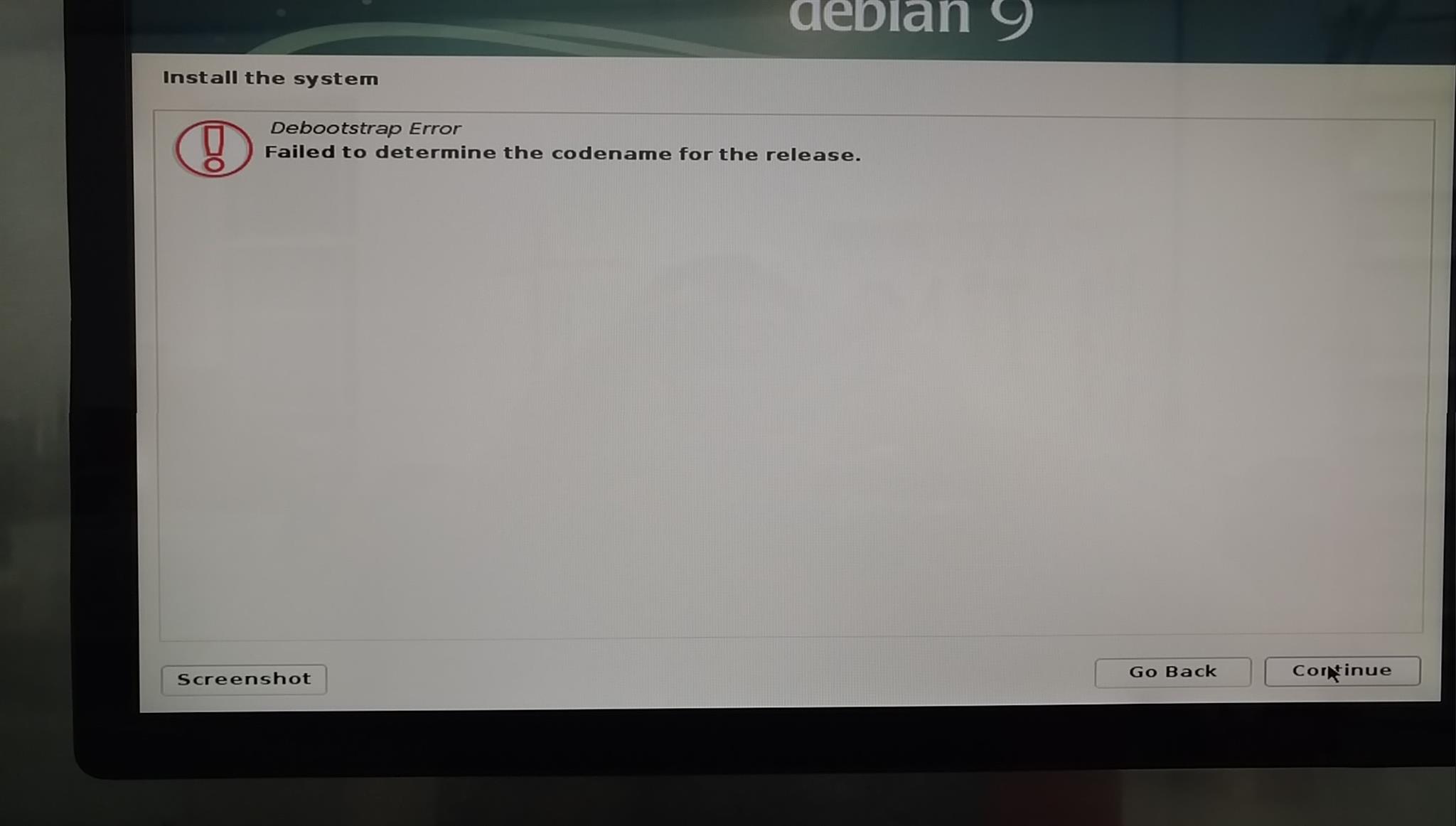

Hey all,
I tried installing linuxcnc for the first time ever today and it did not go well. I initially did the live option and everything was great, my touch screen worked, keyboard worked, life was good, I felt confident to try the graphical installation. That's when it went sideways. I'm not sure if I did something wrong or if I have a problem somewhere. But when it got to the partition section I used the option suggested for new users, and in the next screen it have a bootstrap error? Eventually I had to abort the installation and call it a night. I'm not sure what to do or try and was hoping someone here might help point me in the right direction.
I am installing the preempt RT Debian to use with a 7i92 Mesa Ethernet card.
Installing from USB flash drive, ISO was made using Rufus on a 128gb SanDisk cruiser flash drive (what I had)
PC only has a 128gb SSD, no traditional harddrive, and no DVD drive.
Anything you guys can think of? I'm very new to this and very frustrated..

What distribution did you install?

The one you linked in the 7i92 discussion in the driver board section for the newer hardware, "stretch" I think you called it?
www.linuxcnc.org/testing-stretch-rtpreempt/
I did the top one on that list because I have an amd64

Does it look like this error:
forums.debian.net/viewtopic.php?t=110803
if so there seems to be a workaround

Yes that is the error I'm getting!!!!
I will read that that and try their solution in the morning to see if I can get past it!! Thanks Peter!!

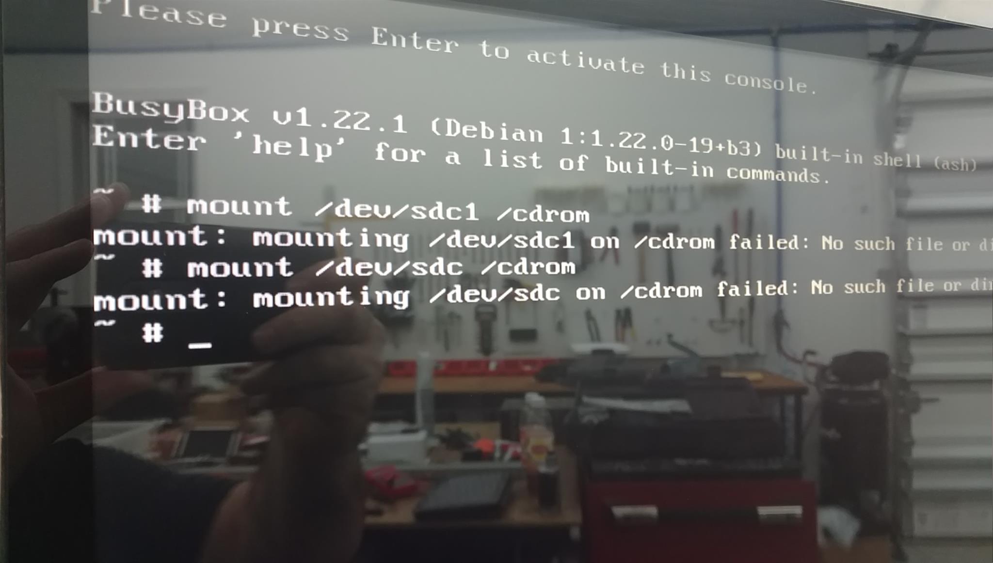

ok, made some progress, o went into the non graphical install mode and was able to get alt/f2 to take me to a black screen where i could type in the:
(mount /Dev/sdc1 /cdrom)
but o got the following response: np sich file or directory... now I realize that's because my stuff is named different, bit how do I find out what it is named? where do I look?
thanks in advance I feel like I'm close to solving this.. but I'm not certain.. I mounted the image file I downloaded and looked through it for anything called cdrom bit didn't see anything..
