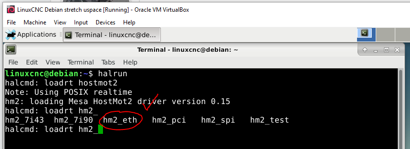

I've installed using "linuxcnc-2.7-wheezy.iso", the live install CD and finally figured out that the reason I don't see "hm2_eth" driver is that it isn't active in this version/configuration. So, now I've spent a bunch of time sorting through other web pages and forum posts and I'm slightly lost as to the easiest path toward success getting the 7i76e up and running.

Replied by PCW on topic Starting out with Mesa 7i76e, what do I need for "uspace"?
I think the easiest path is to install the LinuxCNC Debian Stretch test ISO instead of Wheezy
since this includes the uspace version of LinuxCNC and the required Preempt-RT kernel

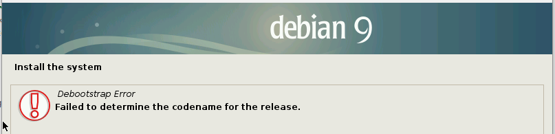

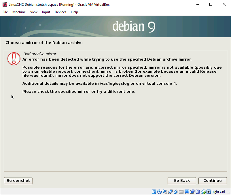

My first step going forward was to download "linuxcnc-stretch-uspace-i386-r10.iso" and perform a test installation using Oracle VirtualBox. I have recently done this with the aforementioned wheezy and it works amazingly well. It likely helps that my computer has plenty of resources to spare.
I got stuck though. I had set it up with no network connection to mirror the actual target PC. It wants to download files from the Debian mirror archive and won't give me options to get past this step. I would have thought a 1.3GB ISO file would have had everything I need to install. The wheezy install can be done completely offline. On startup I picked the Debian Graphical Installer option.
Am I going to be forced to connect to the Internet to complete the installation or is there a way around it?

26 May 2018 12:11 #111152
by Sparky961
Replied by Sparky961 on topic Starting out with Mesa 7i76e, what do I need for "uspace"?
It came to me quickly after the last post. Pressing the "Go Back" button doesn't just go back to the next step. Instead it brings up a list of steps and the one following downloading from the mirror archive can be selected and the installation proceeds. I think it may work offline after all.
Another option is to swap drives and install on a a PC that is connected

26 May 2018 13:03 - 26 May 2018 13:04 #111158
by Sparky961
Letting it run with a valid Internet connection (detected automatically, even) seems to do the trick, though it still makes me unhappy. Everything went off without a hitch with this minor change.
