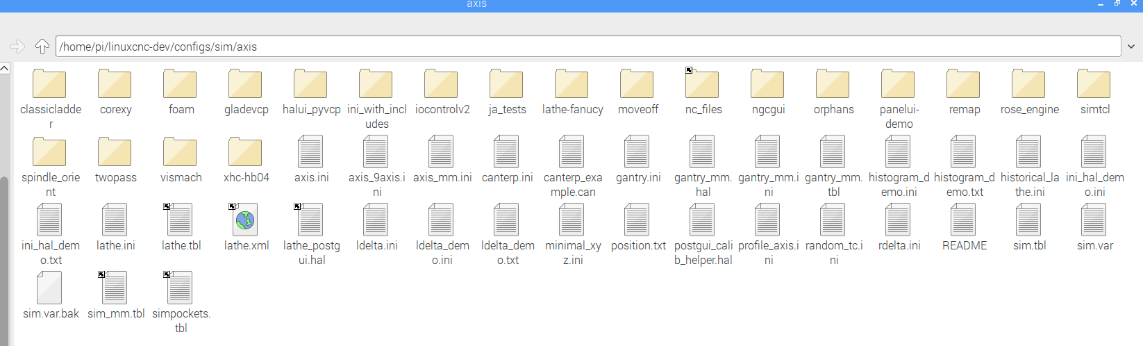

I choose to run Axis (/linuxcnc-dev/configs/sim/axis)

Oh yes,of course sorry, I should have been more precise; I choose axis.ini

Thank you for your help. Alas, I finally found my error! "GLADEVCP= -u handler.py example.glade" was placed under the "[Display]" container, as the linuxcnc command could not find the example.glade file it was failing to display axis. After removing this line it works perfectly.
Sorry for the hassle, thank you.
