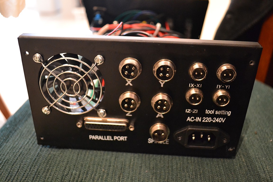

- Posts: 18118
- Thank you received: 5336
17 Sep 2018 19:09 - 17 Sep 2018 19:11 #117684
Replied by PCW on topic A well-functioning configuration for ChinaCNCzone 3040Z-DQ
Actually its not clear what you have, some 3040Z-DQ's come with USB motion controllers and some are parallel port compatible. A parallel port model would work directly with LinuxCNC.
The USB model would not work without some modification (removing the USB motion interface at a minimum perhaps re-wiring the USB interface to the drives/limit switches if its not brought out to a parallel port pinout at some point)
Last edit: 17 Sep 2018 19:11 by PCW.
- ogogon
- Posts: 35
17 Sep 2018 19:47 #117685
by ogogon
Strict, conservative LPT-port. Photo attached.
Ogogon.
P.S. The goat is wonderful!!
Ogo,
Replied by ogogon on topic A well-functioning configuration for ChinaCNCzone 3040Z-DQ
My control station - without any signs of USB.Actually its not clear what you have, some 3040Z-DQ's come with USB motion controllers and some are parallel port compatible. A parallel port model would work directly with LinuxCNC.
Ogogon.
Ogo,
- Todd Zuercher
- Posts: 4794
- Thank you received: 1482
17 Sep 2018 20:24 #117686
Replied by Todd Zuercher on topic A well-functioning configuration for ChinaCNCzone 3040Z-DQ
Did the manufacturer or seller supply you with a Mach3 configuration file? If you happen to have that xml file Stepconfig in Linuxcnc can import it to help build a linuxcnc config.
