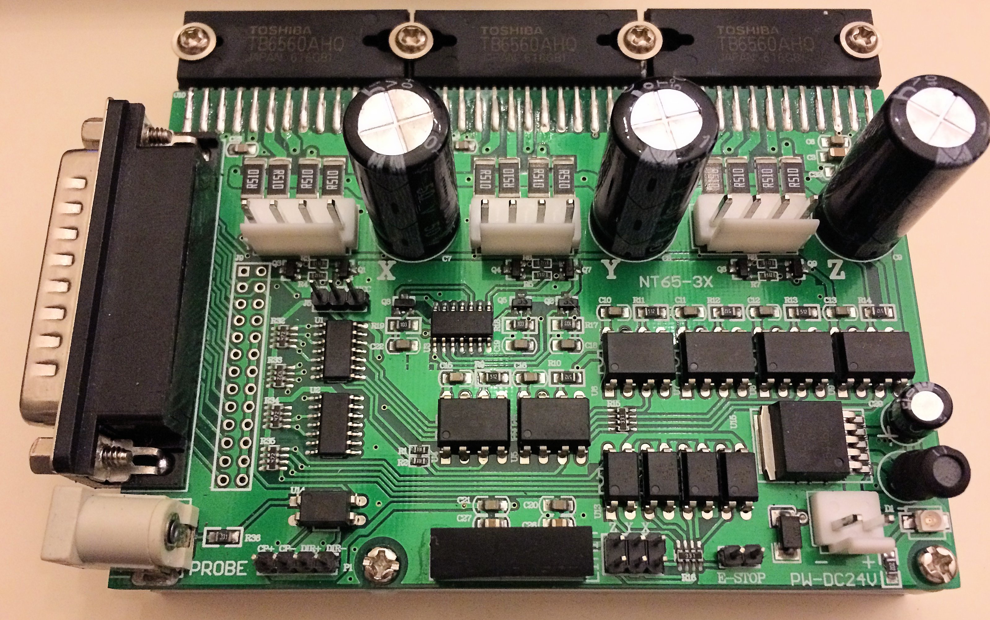

18 Sep 2018 13:13 #117725
by ogogon
By the way, how should this port be configured at the BIOS level?
There was a certain prehistory with this CNC.
When he came to me, I assembled the control car on a small fanless AMD card. LCNC worked without problems and it did not even occur to me to make a backup copy of the configuration. I thought that this will always be so.
I did not like the computer very much, Debian had a poor agreement with its video controller, the jitter was big enough. But, all the same, he did that he needed him.
Further, of course, the computer burned out. I assembled another machine, on an Intel processor. Of course, all the hardware in it is different. Another BIOS, another printer port. Now he shows his obstinacy.
The Z axis, which worked before, froze and does not work.
But, at power-up, the manual shafts on all stepper motors do not rotate freely. Obviously, the controller works and includes microsteps on all axes.
There is one more thing - I found a video from the ChinaCNCzone company. At least there is a logo printed in the corner.
So, the Chinese voiceover, explaining how to tune Mach3, leads to a completely different setting of pins in lpt and inversions on pins.
I'll wrote up a list and lay it out.
Ogogon.

- Posts: 22030
- Thank you received: 7504
18 Sep 2018 17:32 #117733
Replied by tommylight on topic A well-functioning configuration for ChinaCNCzone 3040Z-DQ
I thought you were a seller when i made my comment about sending one for free ! My bad !
Start stepconf wizard, make all outputs as "unused", make pin one "X step" go to page with X axis settings, press on "test this axis" or similar, see if anything moves, if it does not, go back to "pins page" make pin number one as unused and pin number 2 as X step, test, repeat.
For this to work you have to check if the motor drives are enabled by turning them by hand, meaning they have to be locked and not move easily.
If they are not enabled, use "amplifier enable" instead of "X step" and test till you get locked motors, then go back and try the X step version, but do not disable the output that enabled the drives ( usually pin 1 or 14 or 16 or 17, on some chinese bob's pin 9 ).
