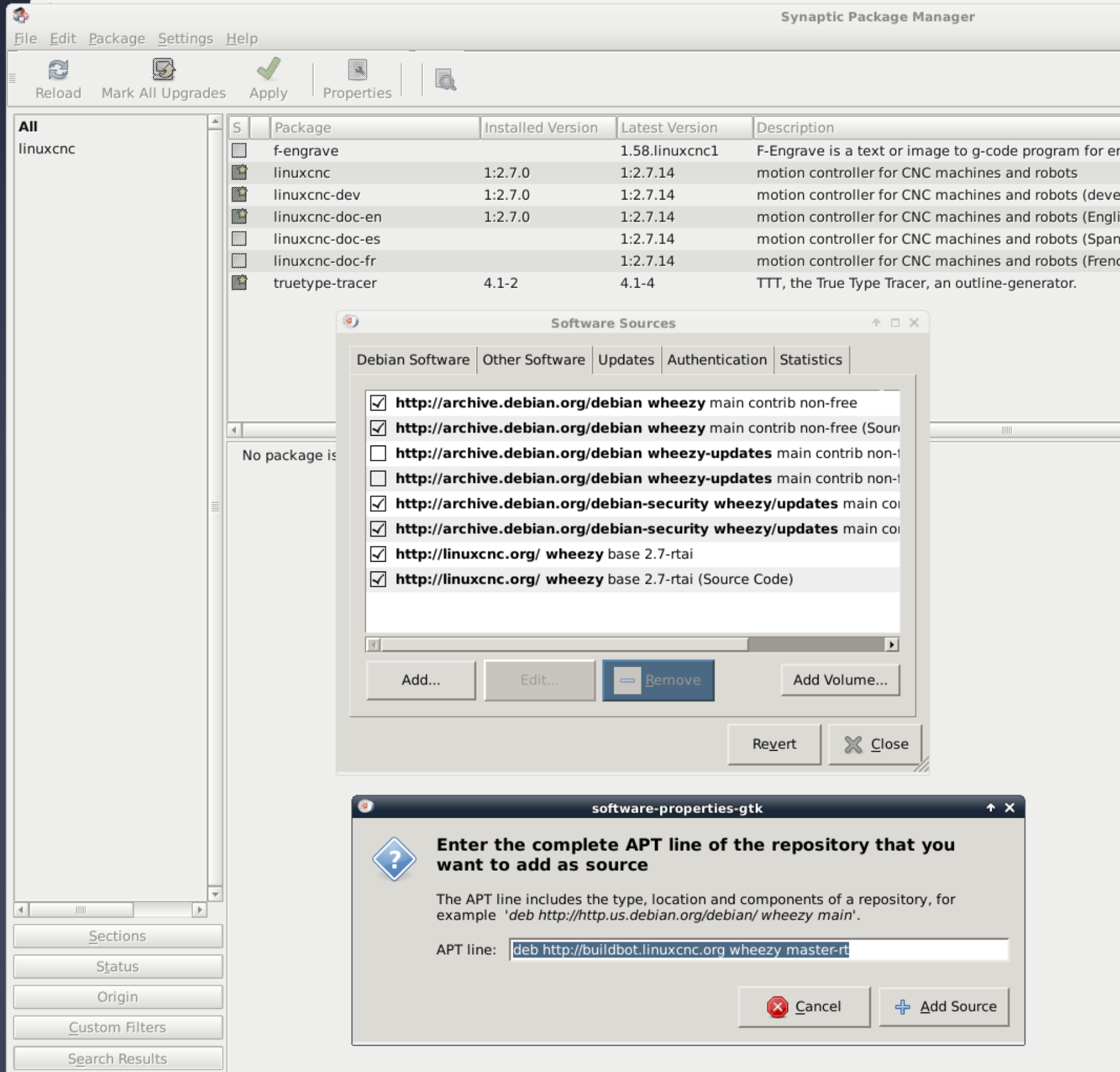

19 Sep 2019 16:25 #145630 by andypugh
Replied by andypugh on topic Upgrading from Axis 2.3.1
Let me make a change to the driver in one of the versions that is built by the buildbot, then I can give you instructions how to install that (rather than you build from source).
In fact, let's try that now.

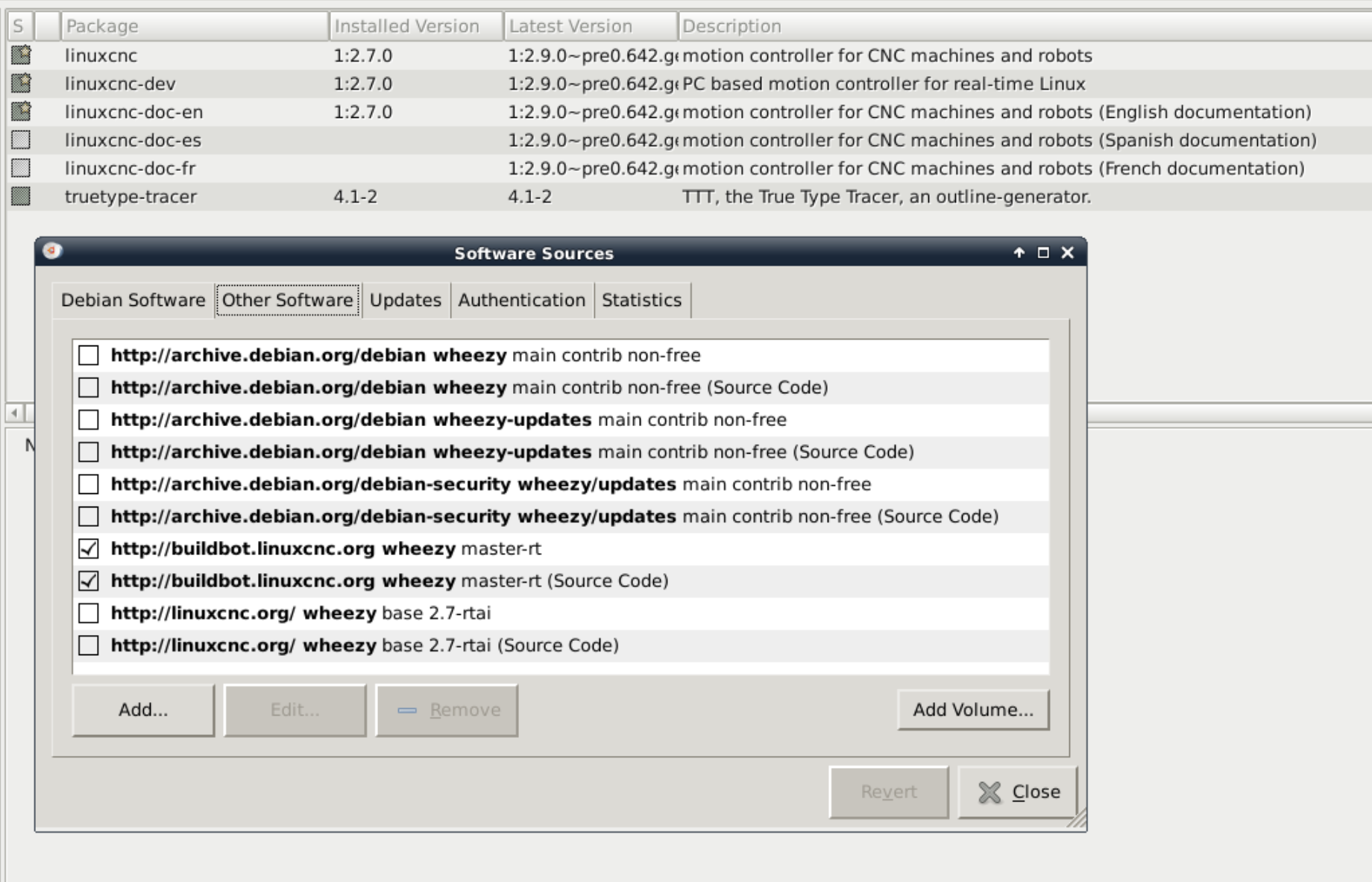

Go to the Synaptic Package Manager, then Settings->Repositories->Other Software->Add
And enter "buildbot.linuxcnc.org/ wheezy master-rt" as shown
Now you should be able to unselect all but the buildbot (including the debian repos, for this excercise)
And then you can upgrade to the 2.9 latest build. If we can make that work then I can add the extra diagnostics we need to that version.
(Alternatively you could consider sending the card to a local LinuxCNC user who knows how to build experimental versions)
