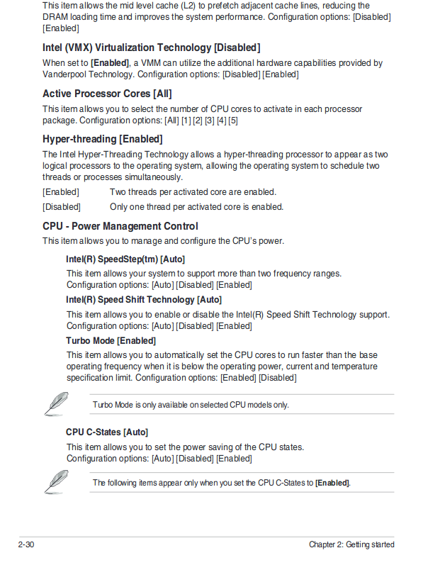

23 Mar 2019 19:00 - 23 Mar 2019 19:02 #129407
by AnnoyingMutt
Replied by AnnoyingMutt on topic Need help installing LinuxCNC
RE Virtualisation
According to this on page 2-30 VT-x is supported (start reading from 2-28) if this is not an exact match for your motherboard it should be about ball park
dlsvr04.asus.com/pub/ASUS/mb/LGA1151/PRI...Z390-P_UM_v3_web.pdf
Screen shot below
Screen shot below
