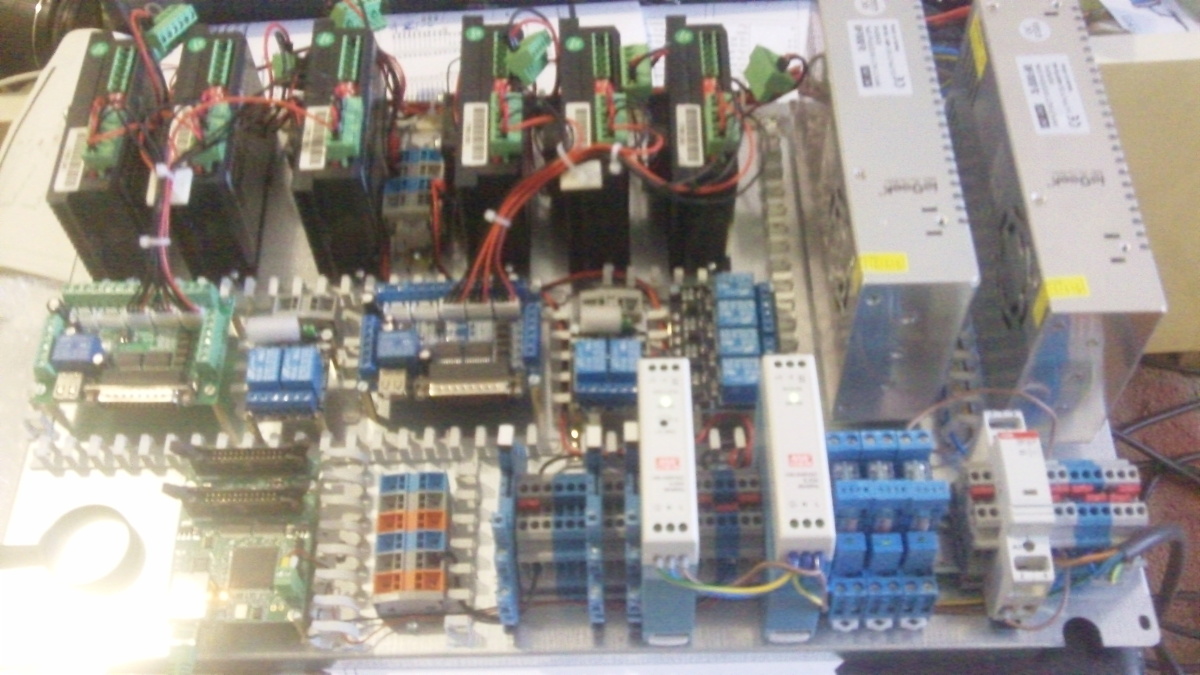

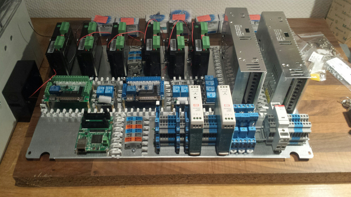

for the ETH
you need the Debian Stretch
not wheezy
compiled here
www.linuxcnc.org/testing-stretch-rtpreempt/
running Mesaflash
mounted
not wheezy
compiled here
running Mesaflash
mounted
