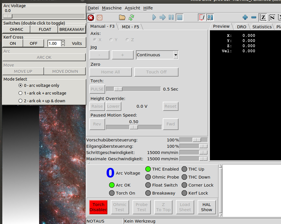

26 Jun 2019 03:44 #137870 by pl7i92
Replied by pl7i92 on topic Installing Plasmac
Thanks to all
First time i got a Glimp on plasmac gui now
I need the time of torch on and gcode running real to calculate the prices
as i did that in pyvcp it may also be done in glade
phil is it a big deal to connect the 2 timers and show value
reset is only at load new gcode

26 Jun 2019 04:50 #137875 by phillc54
Replied by phillc54 on topic Installing Plasmac
No it is not a big deal, just a matter of me getting time to do it.
I know the Statistics tab needs a bit of work and I will get around to it.
Cheers, Phill.
