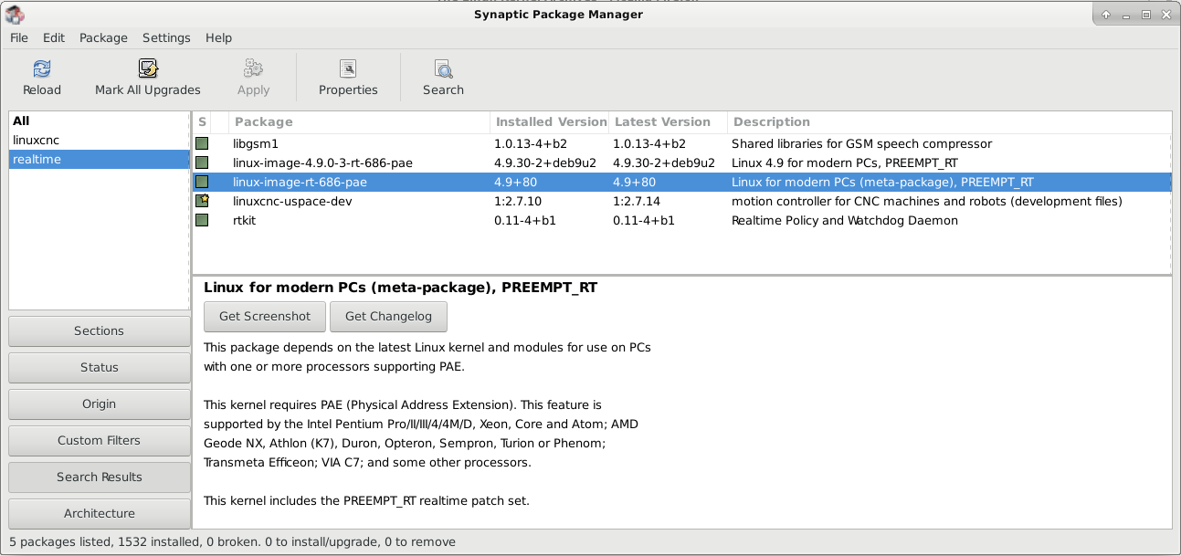

Whilst I applaud the idea, I do wonder if it would be a maintenance headache to keep up to date. It might be better to extract the dependencies from the debian config, for example (dpkg-checkbuilddeps)
Is there any need to patch the kernel for preempt-rt any more? I think that there are pre-patched versions as packages for x86
and pre-packed SD images for Pi:

There are pre-patched versions of many X86 kernels but most are not kept up-to-date
so if you have newer hardware you may need to build a kernel (4.9 is pretty ancient kernel wise)

I assume that Synaptic was finding 4.9 as that VM is running Stretch.
I don't have a Buster handy to do the same search with.
