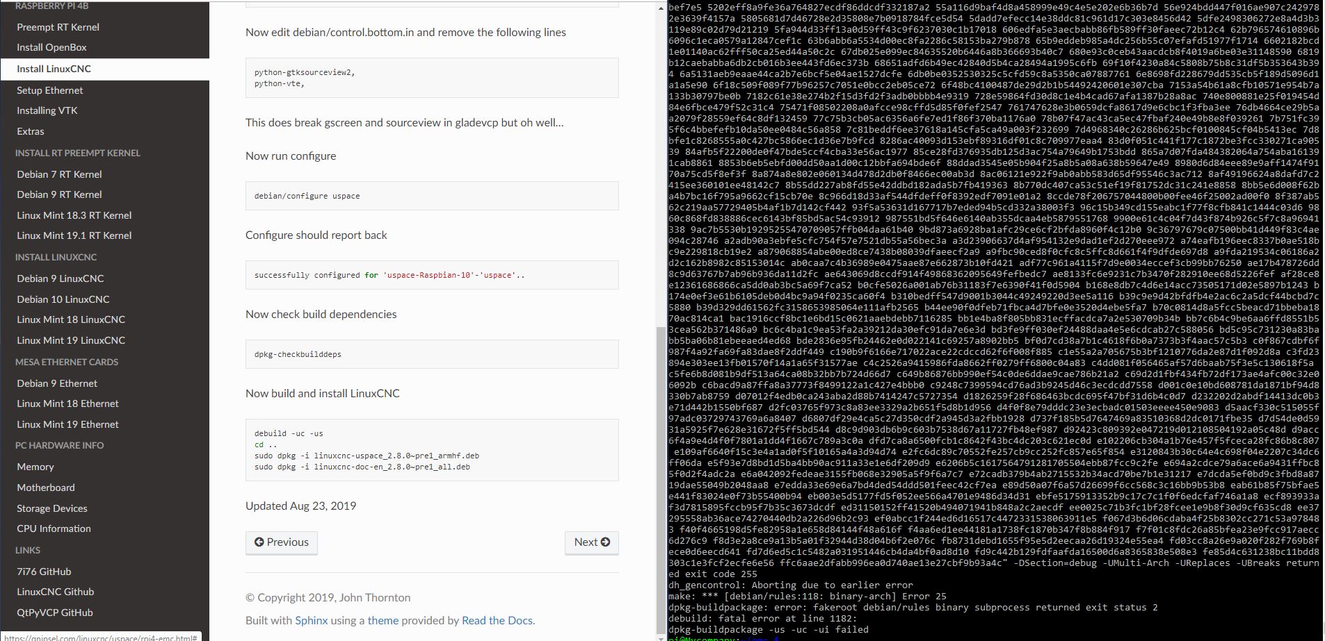

Working on getting my rpi4 up and running and have run into an issue when trying to build and install.
I followed the tutorial by JT (Thank you for the work) multiple times to see if maybe I missed something. After the 4th attempt and also using copy and paste into the terminal I still can not get it to build.
1) Verified using 4.19.71-rt24-v7l+ #1 SMP PREEMPT RT by using "uname -a"
2) Verified successfully configured for 'uspace-Raspbian-10'-'uspace'..
3) Followed all instructions 4 times and keep ending up at the same spot.
On the rpi I do not get the deb packages only the following.
1) linuxcnc_2.8.0~pre1.dsc
2) linuxcnc_2.8.0~pre1_armhf.build
3) linuxcnc_2.8.0~pre1.tar.xz
In the terminal I get the errors shown on the picture
Any input on what I could be missing to get past this spot?
Thank you

Do you _need_ a deb package?
I confess that I gave up trying to make debs on Rapbian10, which is why the Pi4 SD card image that I distributed was a run-in-place build.
If you can put up with typing . ./scripts/rip-environment every time you want to start linuxcnc, or are happy to create a desktop item that calls ~/linuxcnc-dev/scripts/linuxcnc then there isn't much disadvantage to it.

I tried a few more things and then downloaded the .img file you referenced. The .img file runs good on my pi with a max of 32652 on the servo thread after 24hrs and 8 glxgears running. This also includes the occasional file open or transfer as well.
Excited to hook up my 7i76e to it and see how the machine runs.
