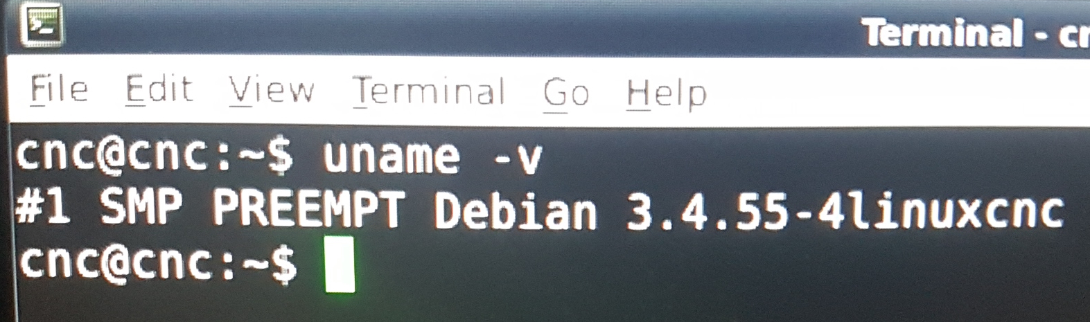

Hello.
For myself and others, just wanted to check, as I understand the Wheezy ISO was updated recently...
When it boots the list gives the option of RTAI kernel, but after starting with uname -v I see PREEMPT.
Am I correct in assuming that the PREEMPT kernel is now included natively in the wheezy ISO without having to go and get the preempt image as we are beyond EOL? Is this the same as preempt RT or not, and thus can an ethernet card be used?
The image at bottom seems to show a PREEMPT kernel (but not preempt RT), but I haven't taken any steps to install one beyond the simple ISO install on its own... Again, I am not sure about the "RT" aspect in this case...

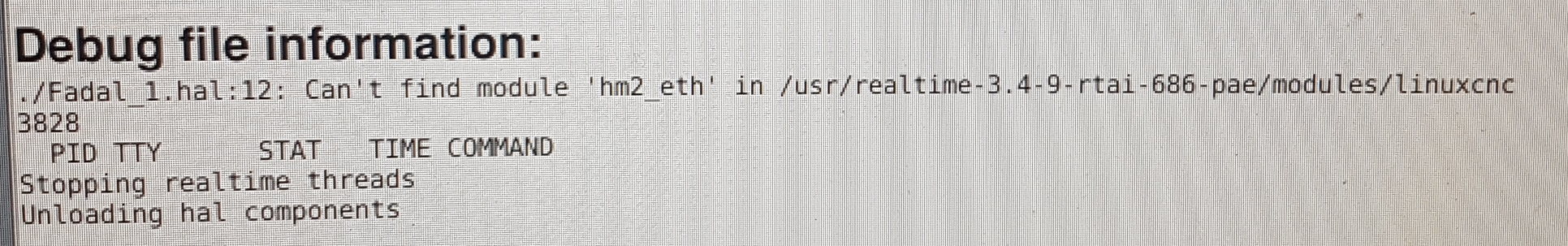

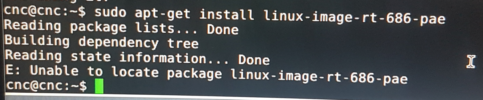

This is what happens when one tries to update to the RT kernel following the Getting Linuxcnc guide.
No updates or dist-upgrades will come down and thus at this step:
sudo apt-get install linux-image-rt-686-pae
So I am basically at a standstill, I can't seem to get an RT kernel into Wheezy, and when I install the stretch version (which DOES have an RT kernel), I continually get "A start job is running for Raise network interfaces" during boot and an avahi error in the debug file stopping linuxcnc from starting (sysctl: cannot stat /proc/sys/net/ipv6/conf/eth0:avahi/disable_ipv6: No such file or directory).
So I seem to be chasing my tail...

- Posts: 22030
- Thank you received: 7504
01 Oct 2019 06:01 #146795
Replied by tommylight on topic Wheezy Image now PREEMPT kernel?
That mesage for waiting is caused by not finding the HDD UUID, so you have to edit
Etc/fstab
To point to the right partition, in this case to the SWAP space on you drive, or just ommit or delete the entry for Swap.
If you have enough RAM, you can safely delete it.
Etc/fstab

- Posts: 19904
02 Oct 2019 23:53 #146945
Replied by andypugh on topic Wheezy Image now PREEMPT kernel?
The RTAI kernel is pre-emptive, so has a PREEMPT in the kernel name. But it is _not_ PREEMPT-RT
