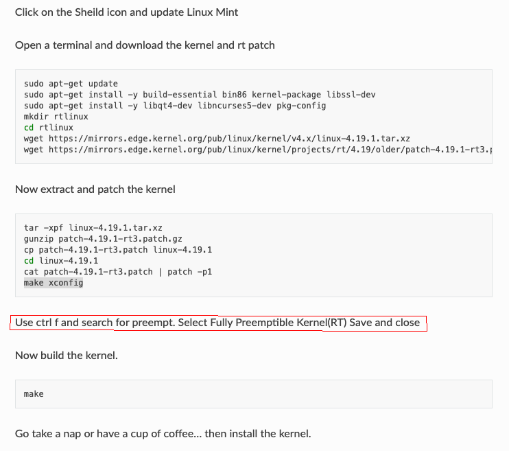

I'm confused about one step on the page gnipsel.com/linuxcnc/uspace/linuxmint19-rt.html
What does the instruction outlined in red mean? Where should I perform "control - f"? Where am I when I select " Select Fully Preemptible Kernel(RT)"? What am I saving and closing?
Is this one of the files I should edit? If so, what file?

make xconfig should bring up a graphical configuration configurator.
The instructions suggest that Ctrl-F in that interface will perform a Find operation to help locate the required configuration switch.
(I have always used menuconfig, which is different)

The instructions should probably be updated to make it clear that a graphical configurator will open. That would have queued me into the need to do this on the machine itself rather that running those instructions through a remote SSH terminal, like I was doing.
My large screen mac is my main computer, so I was copy/pasting stuff from the instructions into a terminal on the mac connected to the linux machine via SSH. That, I thought, would eliminate errors.
Right before the line I outlined in red, it should probably say "The last line (make xconfig) will open a graphical configuration interface."
Then idiots like me will know not to run it from a remote terminal.

If you are compiling and changing kernel configs and stuff, it is kind of a giving that make xconfig would bring up a configuration window.
With that being said, you can certainly forward X11 window over ssh with some configuration required. So if you are connecting to the Linux box from the MAC via ssh, running make xconfig would bring up a graphical configuration window on your MAC.

All I needed to do it the -X in the ssh from the mac as OpenSSH already has X11 forwarding enabled. I think there's a way to configure it to be the default.

X11 needs to be set to forward on the client side and the server side. Plus the server needs to be able to setup X11 authentication.

I do exaclty what you describe very often. I find that ssh -Y works best with my Mac.
make menuconfig works with ssh without X-forwarding.
