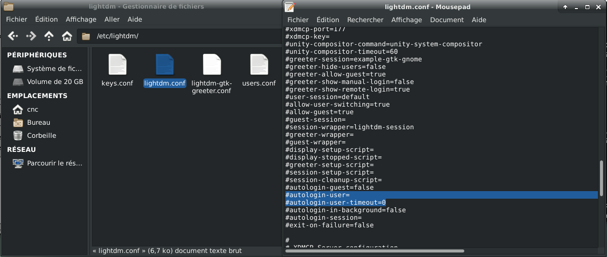

I would suggest that you give more information.
This is the path you have shown /etc/lightdm.conf
this is the path you should have used from the desktop /etc/lightdm/lightdm.conf
Start by showing the full path you have used to get to lightddm.conf

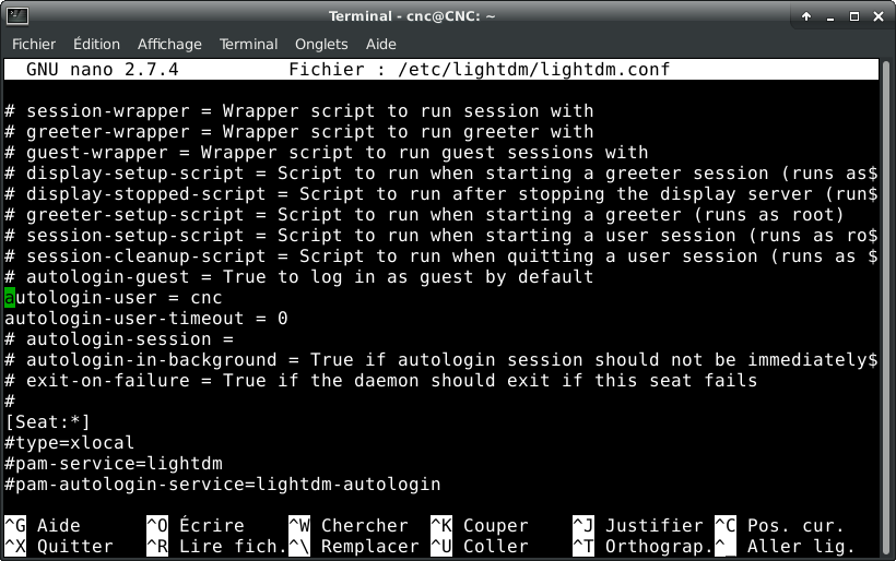

For the first time a read this answer I don't understand (my poor English) the meaning.
I have edited the two lines in the SEAT section and IT WORKS
To resume type in a terminal :Scroll to :change this two lines after SeatSaveQuit
Replied by macsddau on topic Auto login
The above has to be changed somewhere below the "seat".
Long time, just recall that it has to be there.
sudo nano /etc/lightdm/lightdm.conf[Seat:*]autologin-user=username
autologin-user-timeout=0^O^X

- Posts: 22030
- Thank you received: 7504
13 Oct 2019 04:01 #147804
Glad you got it working, and thank you for reporting back.
Replied by tommylight on topic Auto login
I knew it would seem strange, but i tend to remember strange things much easier.
I have edited the two lines in the SEAT section and IT WORKS![]()
To resume type in a terminal :Scroll to :sudo nano /etc/lightdm/lightdm.confchange this two lines after Seat[Seat:*]Saveautologin-user=username autologin-user-timeout=0Quit^O^X
