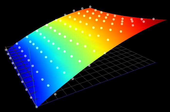

I've been working on a more up to date version of this for 3D printer bed levelling. Not 100% complete.
I was inspired by probekins and eventually found a source. I have added the original files to my GitHub page for you.

The SLT method works but it needs to interpolate between the probe points and cannot work outside of the probed area.
My approach is to fit a linear plane (for rotation transformation - "levelling") as well as a quadratic surface for distortion compensation. A probe data file is read and then python does the number crunching, OpenGL graphical output of the data as well as the height heat map.
The python side is working nicely. The kinematics module is basically done but not tested as yet as I have not decided to use a HAL pin interface between the two or direct memory mapping.
Making this in to QtPyVCP widget would then be the next logical step.

When I get my version working it should provide the following:
1. Levelling
2. Distortion compensation
3. Distortion fade out. Useful for 3D printing so we don't compensate for the full build of the part. For milling / routing PCB's this would be of no advantage.
And all this is done via direct calculation of the of the best fit quadratic surface during kinematics calcs, no interpolation between probe points.
Scott
1. Levelling
