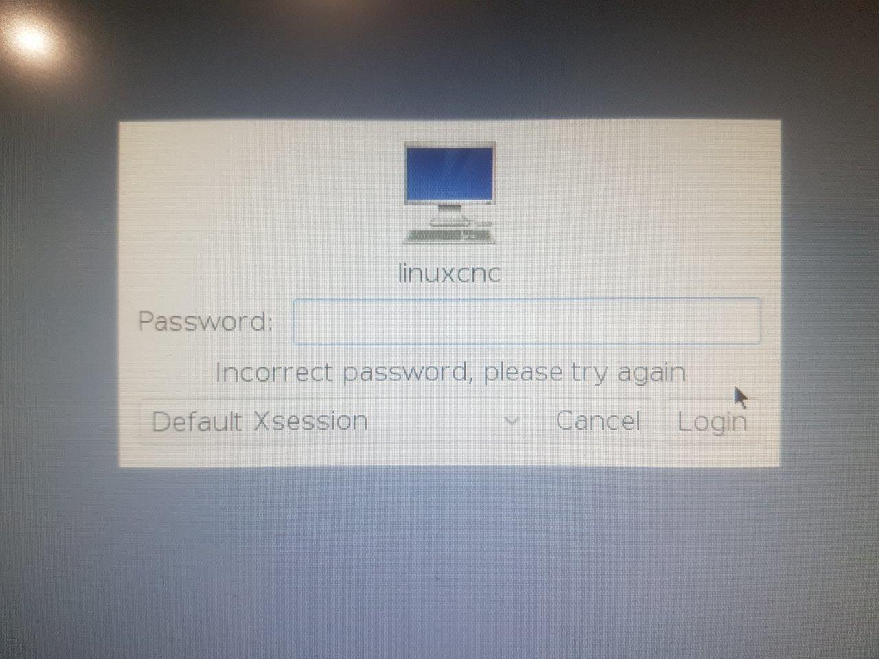

As posted recently I had trouble with the USB Debian ISO install seeing a partition on the SSD so deicded to do a full install and wipe Win10. I've a Dell 9020 USFF with a 480GB SSD.
It's been running live no problem, it was the latest standard install late December off the LinuxCNC site. The only thing was it didn't seem to see the USB wireless stick.
Well it installed with no problem, and it fired up to the login page with the correct Host name I put in, and asked for the password which was "cnc" lower case and it says it's an incorrect! So I reinstalled and the same thing happens. Restart and the same thing.
Any ideas on what happening?
What to do now?? Re-burn the ISO stick?? Try a different Distro??

You gotta login in with your user name, not your host name.
Are you sure you are using the correct user name and not your full name, which is what the debian installer asks when creating the user, then it creates a username based on your full name or you can change it to something else.

Its a common mistake when the so called password box opens you have to put the usr name in press enter and then the psw

During installation, when asked for the ROOT password, do NOT enter anything just continue to the next step where you will be asked to enter a user name and only after this step enter a password when asked.

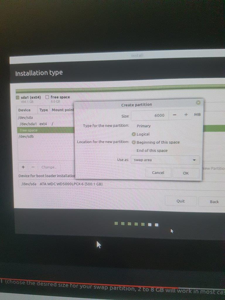

I won't waste time talking about my first attempt but partitioned off a bunch of unusable space trying to do a Swap area. I re-did Win10, reinstalled and Ext4'd most of the free space as primary for ROOT reducing it's size by 6 GB to leave some for Swap as per the video. The install decides automatically what to give Win10. The bit (6GB) I left for Swap says it's unusable. I could have tried to further partition the main Ext4 space for a swap but got scared. So I continued and Mint 19.3 is running with no Swap which is OK if I understand given it's a big space for the primary. Updated etc and Rebooted. Chose Win10 from the boot menu and it goes to a grey screen that looks like woven cloth and sits there. No response to anything so had to pull the plug. Mint 19.3 still works.

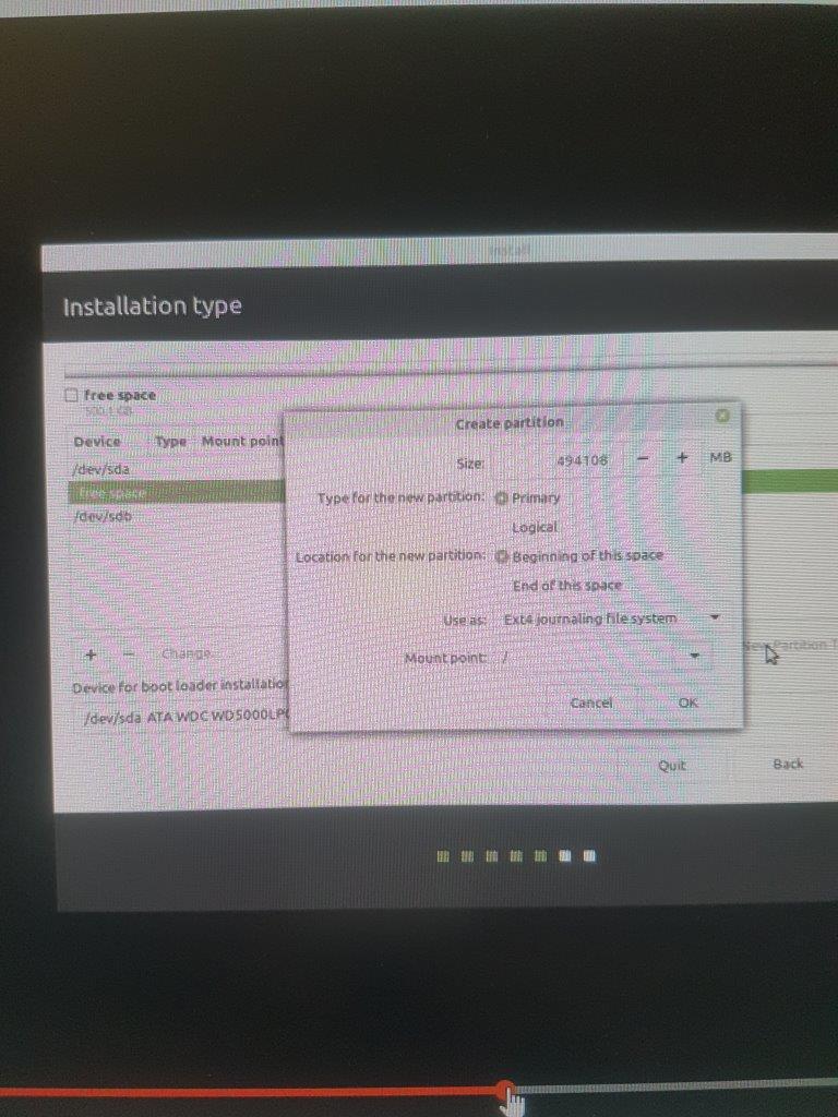

The only difference on my partition system to the video was when the Create Partition input screen comes up it has things about Use the beginning or end of the space. Mine only had format disk box to tick, which I did, maybe this was because that space was formatted NTFS and maybe the video had a Linux format. Two photos from the above video partition input screen attached one Primary and one Swap.
So do I try to sort out why Win10 failed, or just carry on with the much more complicated stuff of building Linuxcnc with what I have, or do I try to get all the hard drive back by wiping the disk some how and reinstalling?

Not to be rude, but you seem to have deleted the windows 10 partition whilst installing Mint. Did you do this on purpose ?
The best option would to reinstall windows 10, shrink your Win10 partition.
Maybe this is helpful:
www.hdd-tool.com/windows-10/howto-change-partition-size.html
Then when you install Mint DO NOT TOUCH the windows partition. Use the free space to create the Linux partitions.
Unless you can achieve this simple task, getting Linuxcnc onto Mint maybe above your current skill set. Tho many of us are here to help.

I will second the opinion that the original problem was that the Debian login box requires you to type in a username where it says "login" and then it asks for the password.
I have made that mistake several times.

1. Tried a Debian Dual boot with a fresh install of Win10, with a working partition. The install partition step didn't see the partition. Don't see what I could have done wrong, I just ran the USB ISO, maybe it's an issue for the great folks who volunteer to look after Admin?? Maybe my relatively new computer clean Win10 install that's had everything updated (BIOS, drivers) and passed all checks is jinxed.
2. Tried a full Debian install and wiping Win10. Got to the login page and it wouldn't take the password or user name (as others suggested) or any other name. There's not much to do wrong here, just installed from the ISO and filled in the blanks, again maybe it an issue for Admin?? Hard to imagine with a tried system.
3. With no Windows and no Linux I had to get the SSD back so Recovered Win10 with a Recovery disc I had made.
4. If Debian won't install what to do? Try Mint 19 with a Mesa Ethernet capability. BigJonT's posts on Linux uspace "building the RT-Preempt Kernel" sounded like it would handle Mesa patches?.
5. I had the partition issues with the Dual Boot. I didn't go near the Win10 partition at anytime, just the free space. I had used the Win Disk Manager to partition the disk before the first Debian install but I formatted it, perhaps I'll leave it unformatted. Thanks for the Disk Manger link, I'll go through carefully.
