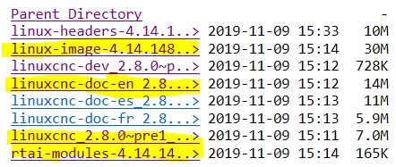

I was previously was using Debian Wheezy and LinuxCNC 2.7.15. I wanted to get to a later version of Linux and LinuxCNC 2.8.0. I did this by getting a new SSD and doing a fresh install of both. That way I had the old drive to fall back to if needed. I chose Linux Mint 19.3 and got LinuxCNC 2.8.0~Pre1 and the RTAI kernel from linuxcnc.org/temp (see below) . I am using the RTAI kernel rather than the PREEMPT kernel because I am using a Mesa 5i25+7i76. I made my first chips yesterday on t his new version.
I only needed these four files for what I was doing.
I figured out how to do this by reading a lot of threads on this site and getting help for specific issues from other posters. I installed five different versions of Linux, some multiple times, before I was able to get to where I wanted to be and be able go through the process smoothly.
I don't know what you mean by "A CNC-function directly with git?". I didn't need anything from GitHub or to use git for this project.
