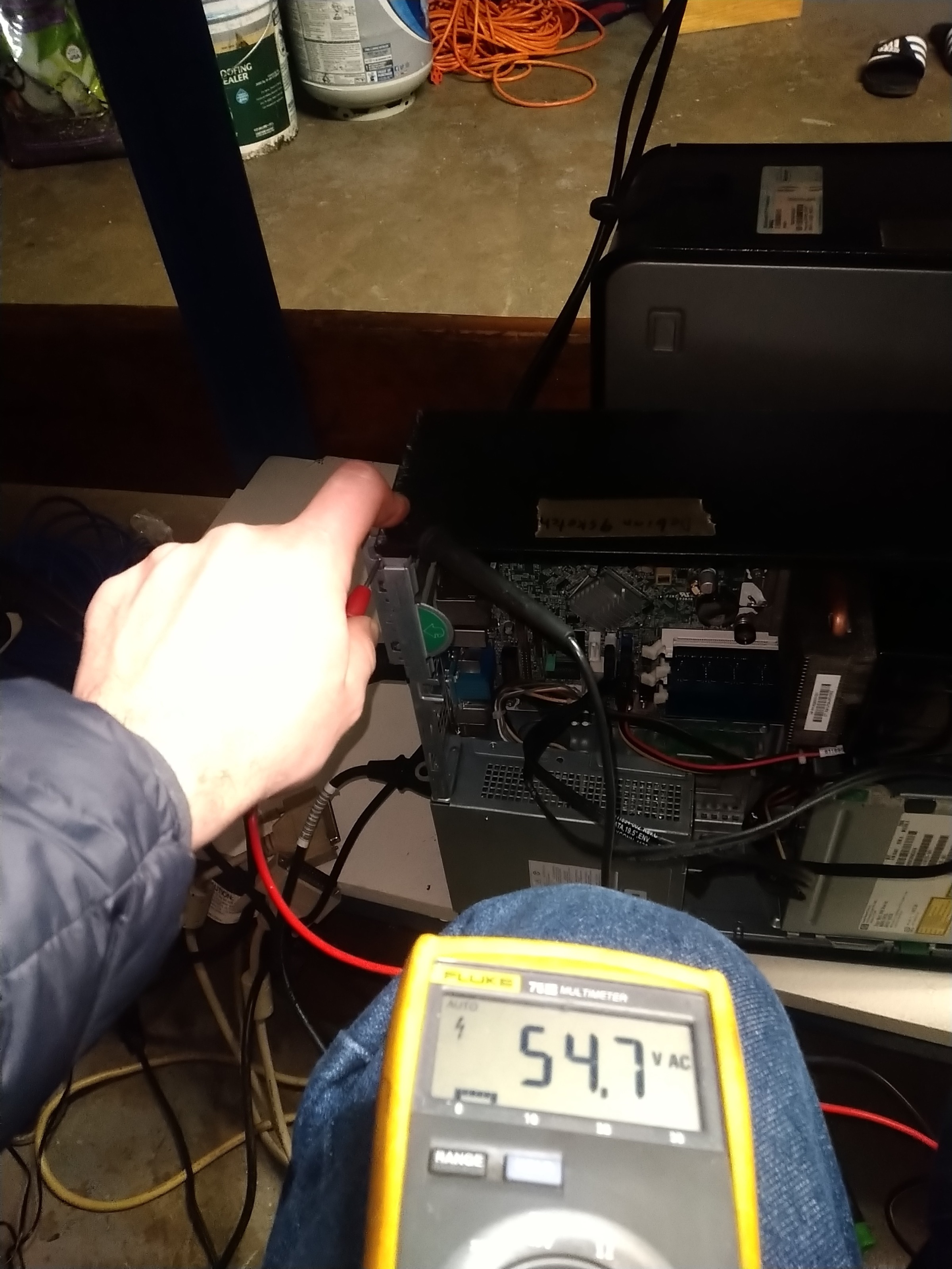

Hey, one final update. The real reason why I was having all these problems was extremely hard to diagnose, but finally I found it. There is some stray voltage, causing my hard drive to be wiped in the time span of a few hours. It seems to be intermittent, but using a grounded plug has solved the problem. Holy crap, I was totally out of ideas, when I went to unplug the monitor cable, I felt an mild shock, and that's what led me to investigate. Look in the picture. I measured 54 VAC. This is a lesson learned the hard way, I won't forget. Anyway, I'm still setting up the 7i76E. I will probably come back online and ask a few questions as I go along. Thanks to everyone who had advice to share.
