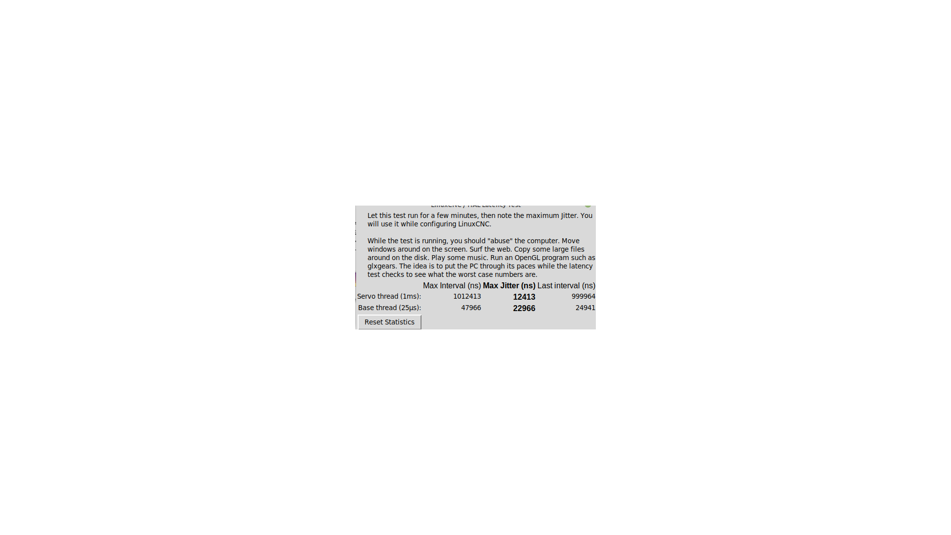

i've been reading through this : linuxcnc.org/docs/html/config/stepconf.html#latency-test
but there is no indication on what software to run for the latency test

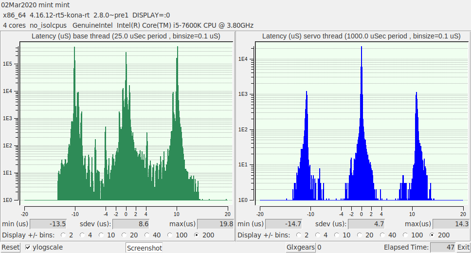

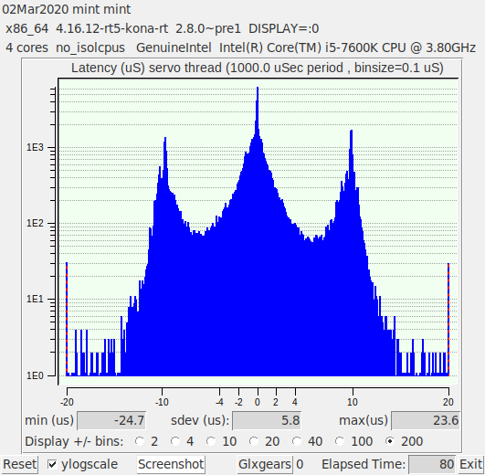

02 Mar 2020 15:35 #159036
by jay1st
Replied by jay1st on topic Computer and LinuxCNC latency test
Ok, so i gave it a spin, 32Go USB drive, no name brand i guess, LIVE Linux running on my current PC (my home PC running W10) and here are the results
26µ secs with a bunch of firefox windows and youtube full screen in full HD
I'm going to try on my MSI laptop that's been sleeping in the attic for 3 years , still has an i7 in it though
