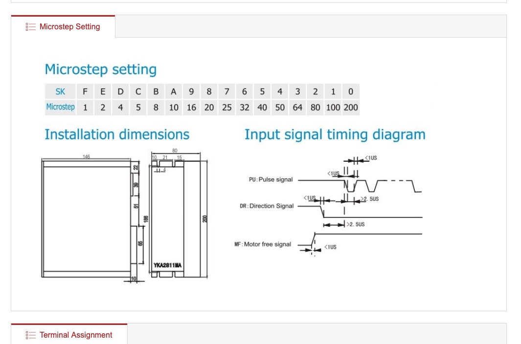

Ok again, thanks for your help and patience. I understand these values are important, and have been trying to follow the guides. I think that the stepper configuration is the problem. When I change the servo thread to 1,000,000 and try to test tune the x axis, with the 10,000 value that had previously worked, the steppers will move but won't hold position. They kind of tick around.
Thats the current .ini and hall for the latest config with the servo thread at 1,000,000.
Thats the diagram I'm trying to decipher. I played around with the values in test tune but couldn't get anything to work. It seems like it takes about 4.5us if I'm reading that correctly for the step time. The other values I'm not even going to guess. Thanks for your help, and let me know if these are even the correct .hal and .ini files. Cheers
