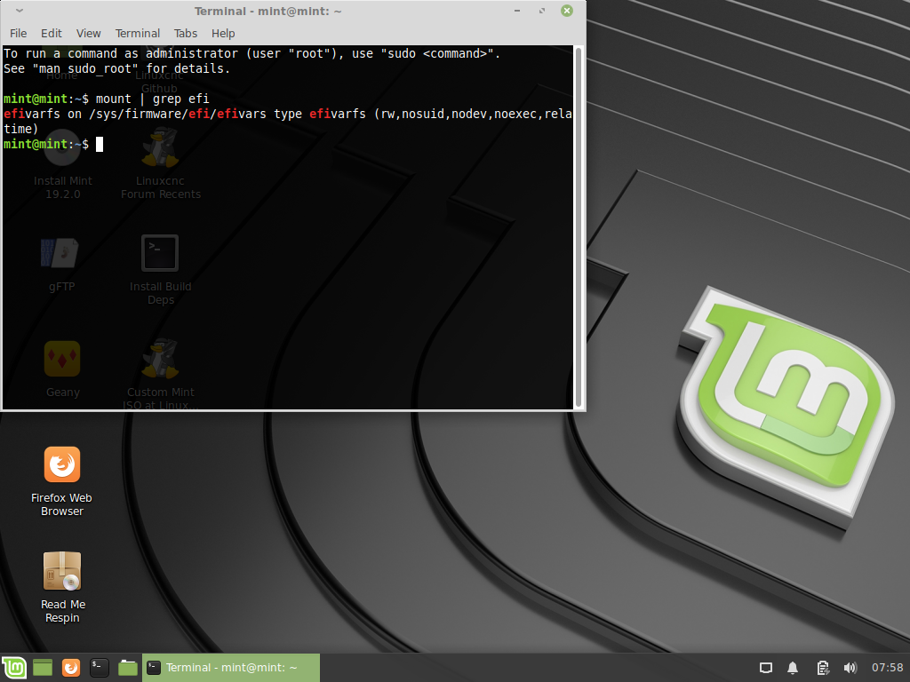

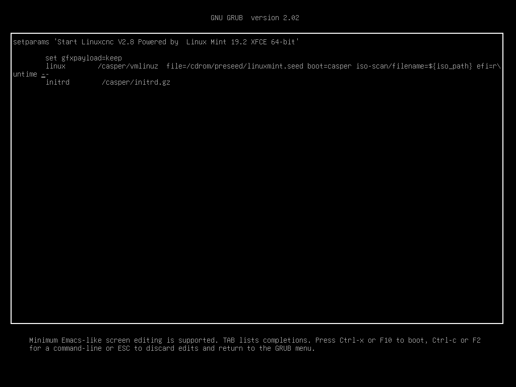

Ok I have a fix that works under VirtualBox using UEFI
When you get the grub boot screen you need to had efi=runtime as per screenshot, note that depending on your screen size it maybe that you can add it on one line
type this
notas per screen shot
if you runYou should get a result as below
If that works you should be ok to install with the ISO you have
type this
efi=runtimenot
efi=r\
untimeif you run
mount | grep efiIf that works you should be ok to install with the ISO you have
Last edit: 02 Apr 2020 03:00 by BeagleBrainz.

Replied by ElStando on topic I am a machinist, not a Linux nerd. Please help me.
It worked!
Thank you very much!
