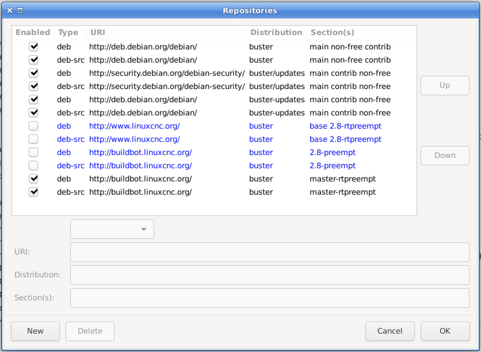

09 Oct 2020 23:53 - 09 Oct 2020 23:55 #185554
by phillc54
Replied by phillc54 on topic LinuxCNC on Debian 10 Buster quick and easy install
These are the packages I have in Synaptic Package Manager I change between them and they all work.
Edit: If you use the buildbot then you need to install the archive signing key:
buildbot.linuxcnc.org/
