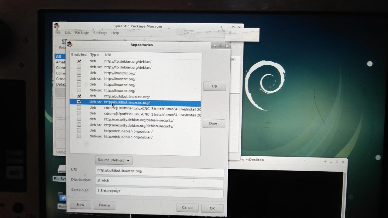

For previous installed 2.7 version, it worked. But after updating to 2.8 one, it doesn't, with the error report showed in attachment. How can it be fixed? Thanks,

It appears there is the KINS section missing from your ini file ???

After installing 2.7ver, then went to Repositories and terminal updating as in attached image. What is the mistake?
