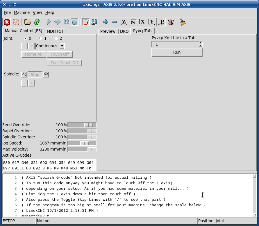

23 Aug 2023 10:45 - 26 Aug 2023 00:56 #278804
by tjtr33
Replied by tjtr33 on topic new install, now cant import tkinter
Update: 26 Aug 2023
Phill Carter proved it works in 2.9.0-pre mumble
Thanks Phill
Hello, on linuxcnc 2.8.4 ,
I cannot load Jepler's teachin.py
and
reloading python3-tk then puthon-tk did not get rid of 'no module anemd tkinter'
both modules show up to date
"python3-tk is already the newest version (3.7.3-1)."
"python-tk is already the newest version (2.7.16-2)."
yet jeplers teachin.py gets error
"Traceback (most recent call last):
File "/home/tomp/linuxcnc/nc_files/teachin.py", line 27, in <module>
import tkinter
ImportError: No module named tkinter
TomP 22Aug2023

26 Aug 2023 01:13 #278994
by tjtr33
I womder if a python2/Tkinter or pyton3/tkinter file could be on a tab?
I originally used a floating pane using python3/tkinter file for a project.
Then I thought , hey, embed that in an axis side panel or tab.
That began the trip here to 'embed py-mumble in a tab' realm.
The control panel created has no hal pins, no hal conmnections.
Yet it controls/reports on hardware.
It controlls stuff used while machining but not under LCNC control.
Its very independant, just close at hand.
I attacj an example pyTk cpntrol pane
( requires a /dev/ttyACM0 device connected
... any arduino with a dip 328p will do , no sketch required )
just thinking out loud
tomp
