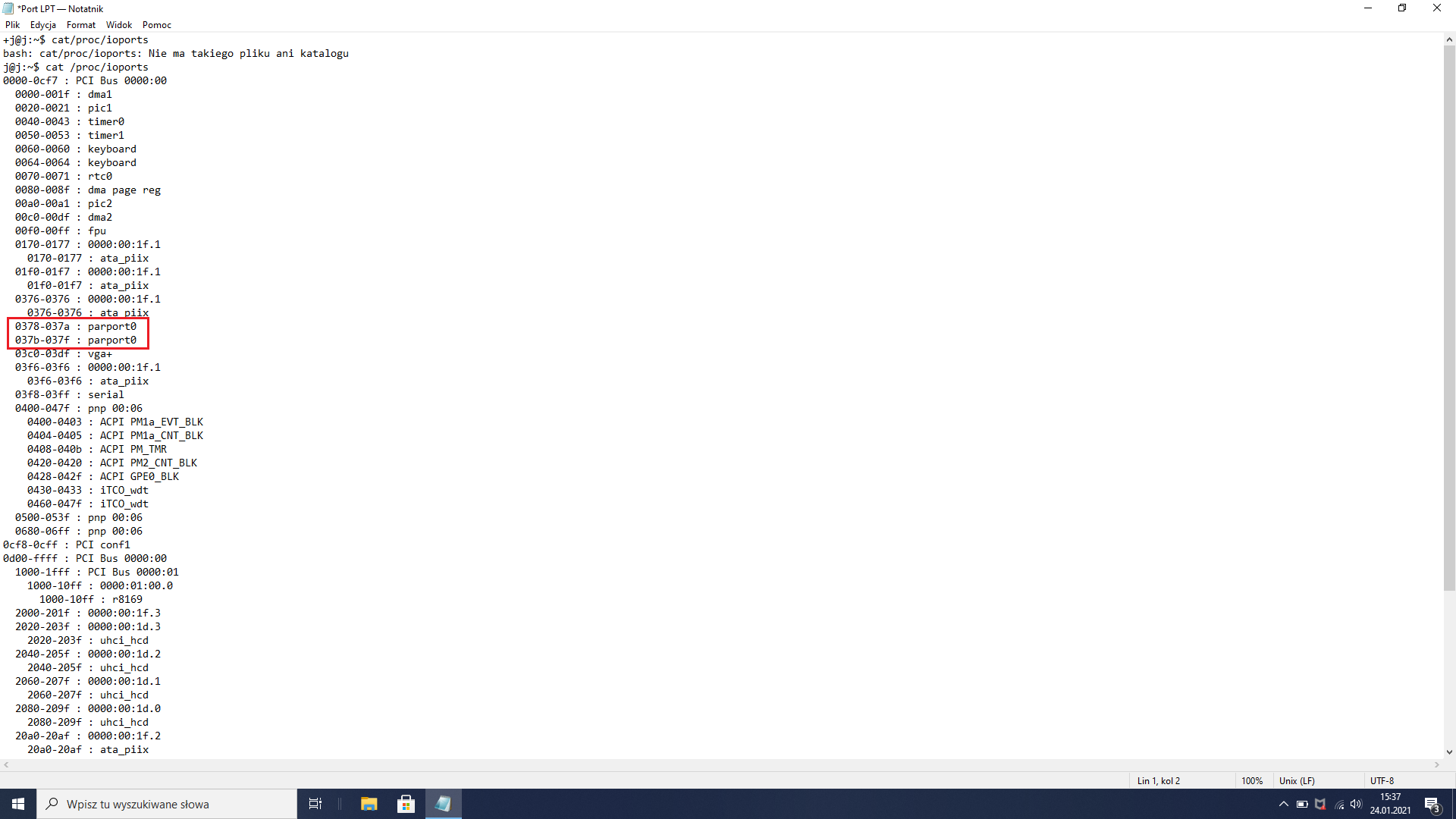

Hello, I installed 2.7.14, I changed the archive source to
deb archive.debian.org/debian wheezy main contrib non-free
deb-src archive.debian.org/debian wheezy main contrib non-free
# deb archive.debian.org/debian wheezy / updates main contrib non-free
# deb-src archive.debian.org/debian wheezy / updates main contrib non-free
deb archive.debian.org/debian-security wheezy / updates main contrib non-free
deb-src archive.debian.org/debian-security/ wheezy / updates main contrib non-free
to have version 2.9 and, interestingly, I can not enter the LPT port number in the configuration, and after entering manually in the hall file 0x378, no engine response, the system is uploaded to the SSD.
What's wrong, for this D945GCLF2 board is too weak for linuxcnc 2.9?

sudo lspci -v | grep par
in a terminal ?

j@j:~$ sudo lspci -v | grep par
[sudo] password for j:

Nie widzę portu LPT

Nie widzę portu LPT
- jarcysgru
- Posts: 104
- Thank you received: 6
23 Jan 2021 20:48 - 23 Jan 2021 21:23 #196361
by jarcysgru
Replied by jarcysgru on topic Re:Intel D945GCLF2
Czy to jest port LPT I/O ports at 20e0.
Ja wisywałem 0x378
Ja wisywałem 0x378
Last edit: 23 Jan 2021 21:23 by jarcysgru.
- Thank you received: 4652
23 Jan 2021 21:28 #196362
lspci won't show onboard ports, and 0x378 is often an onboard port.
what do you get with:
cat /proc/ioports
Replied by andypugh on topic Re:Intel D945GCLF2
in a terminal ?
cat /proc/ioports
- jarcysgru

24 Jan 2021 14:45 - 24 Jan 2021 14:48 #196409
by jarcysgru
j@j:~$ cat/proc/ioports
bash: cat/proc/ioports: Nie ma takiego pliku ani katalogu
j@j:~$ cat /proc/ioports
0000-0cf7 : PCI Bus 0000:00
0000-001f : dma1

So I have 378 what these entries mean 037a 037b 037f?
0378-037a: parport0
037b-037f: parport0

24 Jan 2021 14:51 #196411
Well, there it is, at 0x378.
