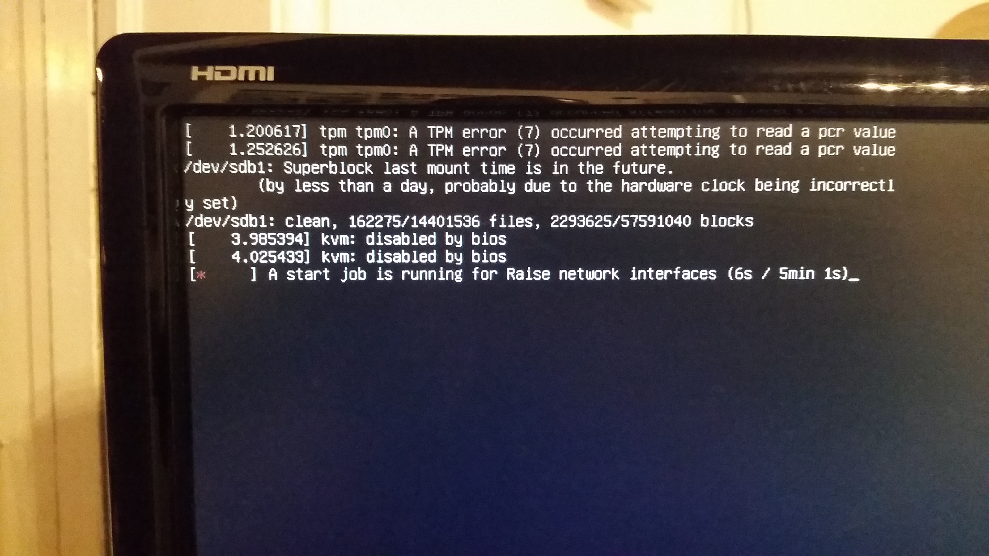

I also get a brief message on startup:[ 1.200617] tpm tpm0: a tmp error (7) occurred attempting to read a pcr value
Screen shot attached below with more info. Not sure if it matters as linuxcnc seems to load fine?

Regarding the start up messages, should I ignore them?

One is for Trusted Platform Module and the other is for virtualisation. Both should be disabled for use with LinuxCNC.

Yes.Regarding the start up messages, should I ignore them?
