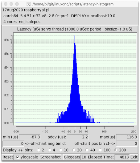

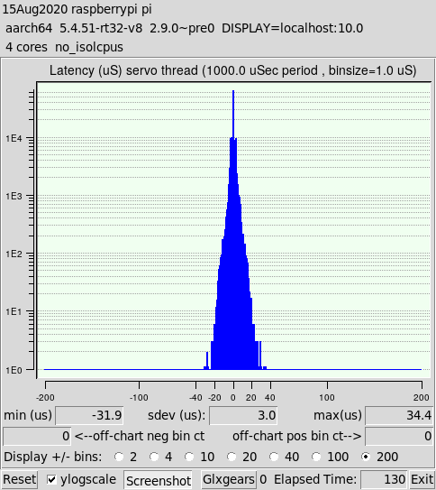

This is latency test obtained from command:
latency-histogram --nobase --sbinsize 1000 --show

Great work, I followed your instructions and used your LinuxCNC package and it worked a treat.
I also built a Run In Place LinuxCNC 2.8 install withoput issues.
It has better latency than my old 32 bit version which also needed isolcpus=3 plus a few tweaks in cmdline.txt to get a reasonable latency. It is also much more responsive than the 32 bit version.
Thanks again.

That's really good latency. If its reliable long term it would allow good step
generator/encoder performance using the RPI's GPIO.

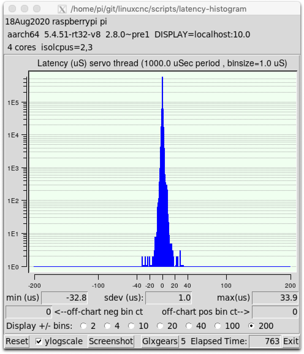

The only issue is that you cannot use LinuxCNC 2.8 as it doesn't recognise the later PREEMPT_RT kernels.This is now fixed.
Replied by phillc54 on topic RPI4 Raspbian 64 bit & LinuxCNC
I have only tried this 64bit version on a sim so far. I did run PlasmaC on the Pi4 with the 32bit version and if performed reasonably well. I run it headless using SSH. From what I have seen of the 64bit version it should perform better than before. Hopefully I will get some time this week to give it a try.@phillc54, is it running plasmac?
