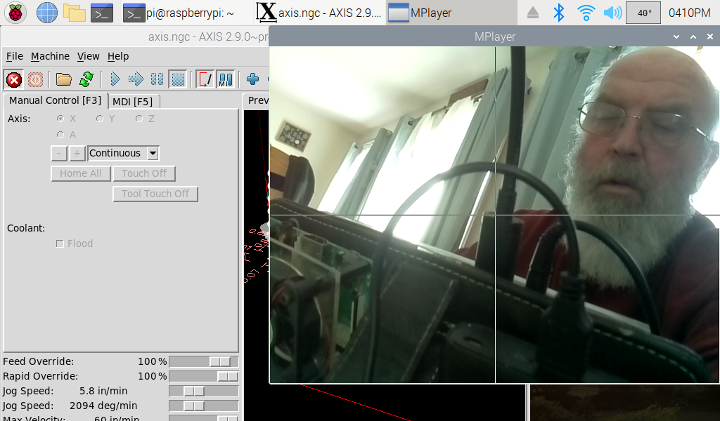

06 Mar 2021 21:55 - 14 Mar 2021 08:52 #201223
by tjmarch
Replied by tjmarch on topic RPI4 Raspbian 64 bit & LinuxCNC
Last edit: 14 Mar 2021 08:52 by tjmarch. Reason: Added filke
The following user(s) said Thank You: elovalvo
- tjmarch
- Posts: 152
- Thank you received: 22
14 Mar 2021 08:52 #202198
by tjmarch
The kernel is non-real-time that is why my cam works, is this ok to use? Kernel must have been configured as low latency but not Full Real Time option before compile. Elovalvo maybe you could give info on which Real Time option, General -> Preemtion Model was selected before compiling this kernel

15 Mar 2021 08:16 - 15 Mar 2021 14:16 #202316
by elovalvo
Replied by elovalvo on topic RPI4 Raspbian 64 bit & LinuxCNC
I confirm that the version in this link
forum.linuxcnc.org/9-installing-linuxcnc...xcnc?start=10#181585
was compiled with the Full Preempt option.
Maybe tjmarch made an update that changed the contents of the /boot/config.txt file.
What answer do you get to the terminal command: 'uname -a'?
It should be 'Linux raspberrypi 5.4.80-rt44-v8+'
Last edit: 15 Mar 2021 14:16 by elovalvo. Reason: Add a question

17 Mar 2021 07:22 - 17 Mar 2021 07:40 #202565
by tjmarch
The problem is when you invoke Linuxcnc or latency-test form the command line. It says it is running Posix non real-time. If it were compiled with fully RT kernel option it would say running real-time. I suspect it was compiled with low latency desktop option. The full RT kernel option is not a available option when compiling some newer kernels. If it were compiled with low latency decktop I am just wondering if this option is good enough to use. And to note I have not made any changes to the /boot/config.txt file and uname -a still reports a RT kernel label which is just a label that is added by the RT patch for the kernel being compiled
