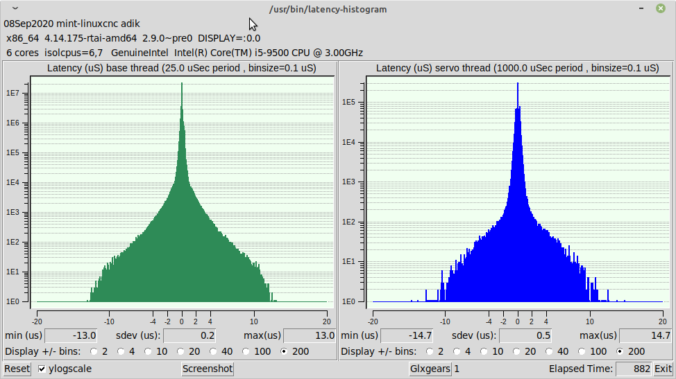

Hello again,
I decided to compare jitter under kernel 5.6.19-rt12, v4.14.175 and v4.19.114. I wanted v4.19.14, because supports Intel UHD 630 graphics (Intel i5-9500).
I'm stuck at the stage of compiling rtai-modules:
Error:
a bit earlier:
Has anyone successfully compiled the rtai-modules for v.4.19.14 and knows how to correct this error?
Under the v4.14.175 rtai-modules compiles w/o problems, jitter is great, but graphics acceleration does not work for my i5-9500 CPU. I also can't set the resolution to 1920x1080px.
Graphics card UHD 630 under kernel v.4.19.14 works OK, unfortunately I can't compile the RTAI modules.

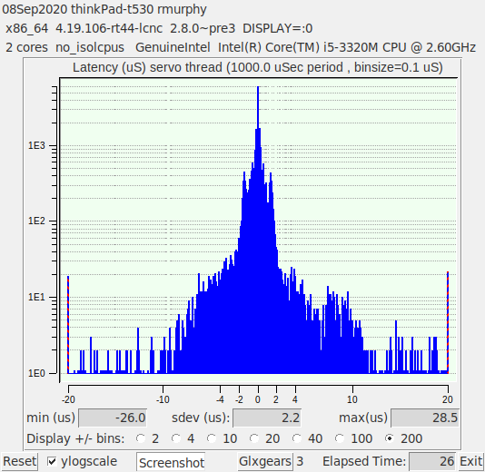

Are you wanting the RTAI kernel or the RT_PREEMPT kernel ?

What hardware are you going to be using to control your machine ?
I think it may be helpful if you state your goal and the hardware you hope to use with Linuxcnc ie: Mesa or Parallel port. As you have been jumping back & forth between RTAI & RT_PREEMPT.
As far as I know there is only one rtai version that will work with Linuxcnc, as I said before there as been a lot of work into getting Linuxcnc & the rtai kernel to work.
As it stands the current rtai kernel that is known to work with linuxcnc can have limited graphics.

Hardware: Mesa 7i76e card.
I'm waiting for the delivery of DYN4 servo drives from DMM.
For my config (Core i5-9500, M.2 SSD, mini-itx mainboard) RTAI with kernel 4.x offers lower jitter (13us), RT_PREEMPT with kernel 5.6.19 jitter jumps to 80-100us.
