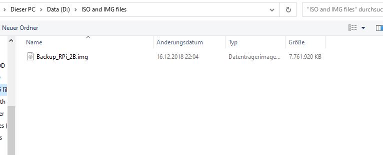

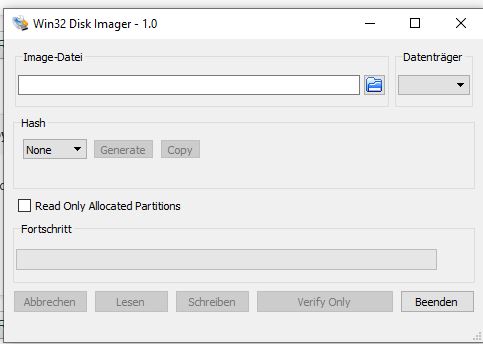

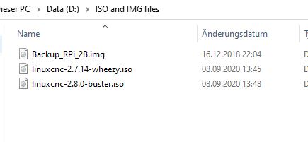

Win32diskimager reads only .img files, but I have 2 .iso files.

No it reads ISO files, I've used it for years. It works and works perfectly every time I've used it.
If it didn't read ISO files no one would recommend it for writing an ISO file to a USB stick.

Have you choosen to look for iso?
