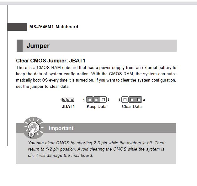

Assuming it is a desktop PC, those will always have a "Clear CMOS" jumper or a very small button on the mainboard.
Even removing the battery (2032 button type) for 10 to 15 minutes will reset the BIOS settings removing the password.
If it is a HDD password, none of the above will work, but changing the HDD will work.

07 Mar 2021 22:33 #201375
by Aloha
Replied by Aloha on topic Password required to start LinuxCNC from USB stick
- Posts: 21922
- Thank you received: 7468
07 Mar 2021 22:35 #201377
Replied by tommylight on topic Password required to start LinuxCNC from USB stick
Yup, that is it.
Move the jumper, leave it for 3 seconds, move it back to where it was.
Boot the PC.
Boot the PC.

07 Mar 2021 22:39 #201378
by Aloha
It's not easy to access. I'll do that tomorrow.
