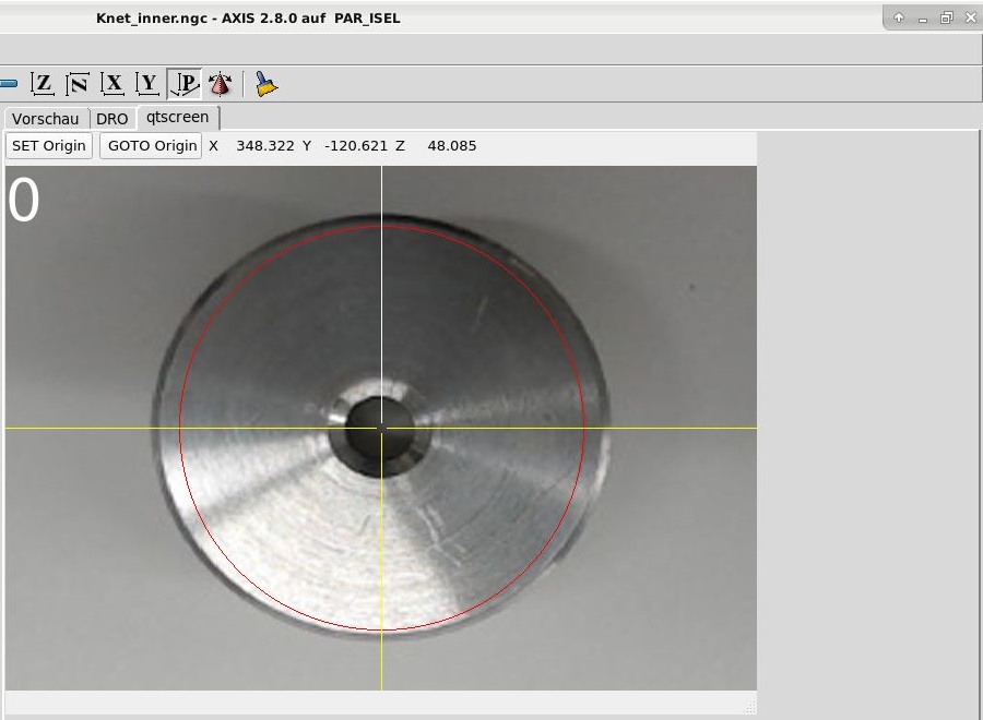

AXIS.INI
[DISPLAY]
EMBED_TAB_NAME= qtscreen
EMBED_TAB_COMMAND= halcmd loadusr -Wn qtvcp_embed qtvcp -d -c qtvcp_embed -x {XID} cam_align
AUTOLOGIN
sudo nano /etc/lightdm/lightdm.conf
Xfce usage
xset
SCREENSAVER
sudo xset s off
POWER MANAGEMENT
sudo xset -dpms
SETTINGS -> SESSION -> Autostart
uncheck Screensaver (launch Screensaver)
sudo apt-get install gedit
sudo apt-get install screengrab
sudo apt-get install samba
sudo apt install libsmbclient smbclient gvfs-backends
sudo smbpasswd -a USERNAME
make a safe backup copy of the original smb.conf file
sudo gedit /etc/samba/smb.conf
AXIS.INI
[DISPLAY]

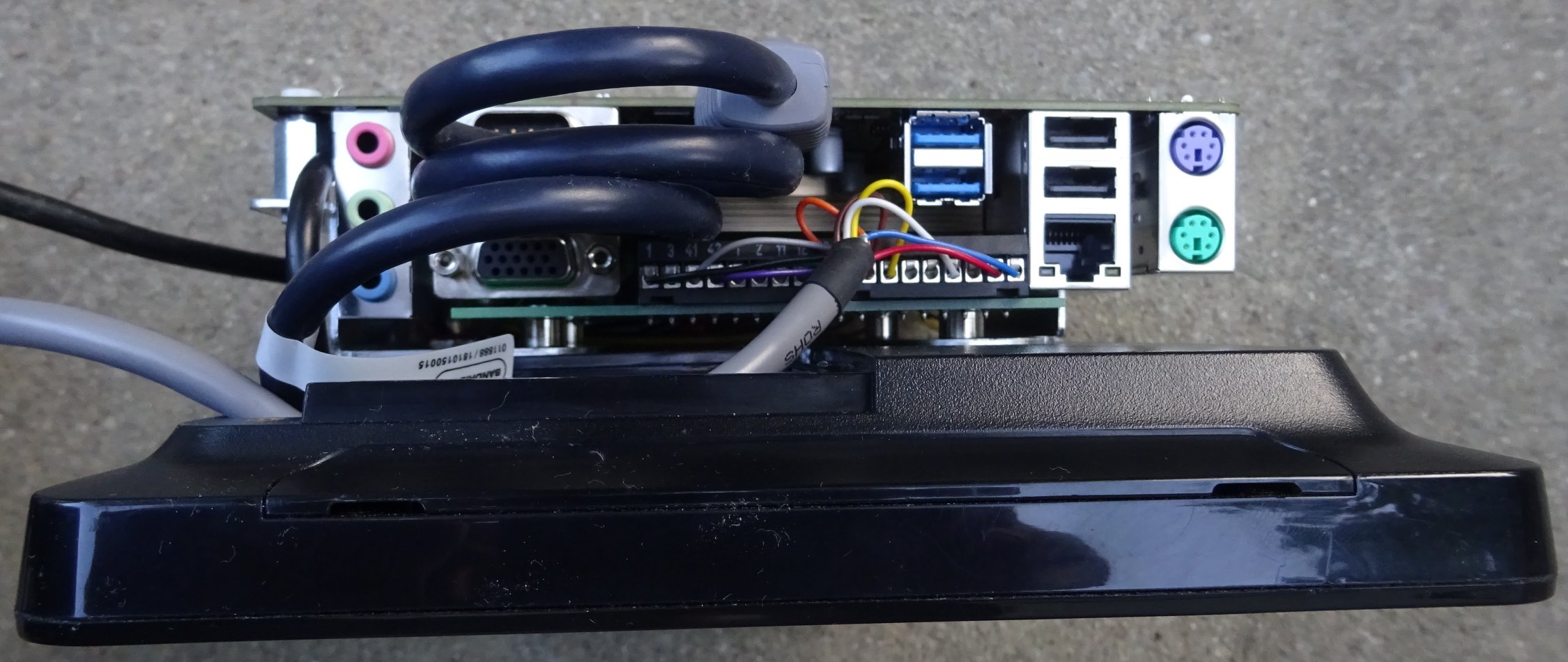

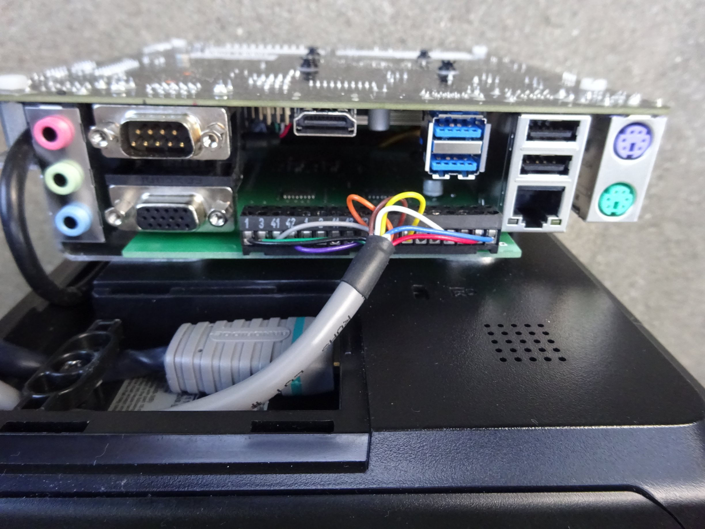

- dm17ry
- Posts: 212
- Thank you received: 91
19 Sep 2020 18:00 - 19 Sep 2020 18:02 #182793
by dm17ry
i'm using this mobo on the PnP machine for quite some time. with buster/preempt rt, a PCI servo interface card, 222us servo thread period. works ok except linuxcnc reports unexpected realtime delay *if* started immediately after boot. but after a few seconds it seems to get stable. haven't investigated the cause
Replied by dm17ry on topic linuxcnc 2.8.0-buster ISO 2020 Sept. 7
Maybe someone here did try it?www.alternate.de/GIGABYTE/GA-J3455N-D3H-...html/product/1503683?
