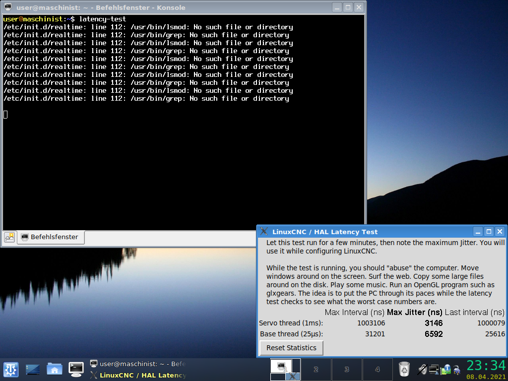

08 Apr 2021 15:33 #205358
by clifo
Replied by clifo on topic ISO to test: Exegnulinux remasterd with LinuxCNC, a lots of tools and no systemd
/usr/bin/latency-test
/etc/init.d/realtime: line 112: /usr/bin/lsmod: No such file or directory
/etc/init.d/realtime: line 112: /usr/bin/grep: No such file or directory
insmod: ERROR: could not insert module /usr/realtime-4.14.174-rtai-amd64/modules/rtai_hal.ko: File existsPlease Log in or Create an account to join the conversation.
- twoflowers
- Visitor
08 Apr 2021 15:37 #205359
by twoflowers
Replied by twoflowers on topic ISO to test: Exegnulinux remasterd with LinuxCNC, a lots of tools and no systemd
The SHA checksum of the image is correct?

- twoflowers
- Visitor
08 Apr 2021 16:45 #205375
by twoflowers
Thank you for testing. The lines with "/usr/bin/" are not quite cosmetic, but you should be able to run "latency-test" after rebooting, as long as you did not run any other realtime-application. Can you try this (rebooting and running latency-test only) and report back?
I just patched /etc/init.d/realtime to use the correct path, so it will be corrected in the next version.

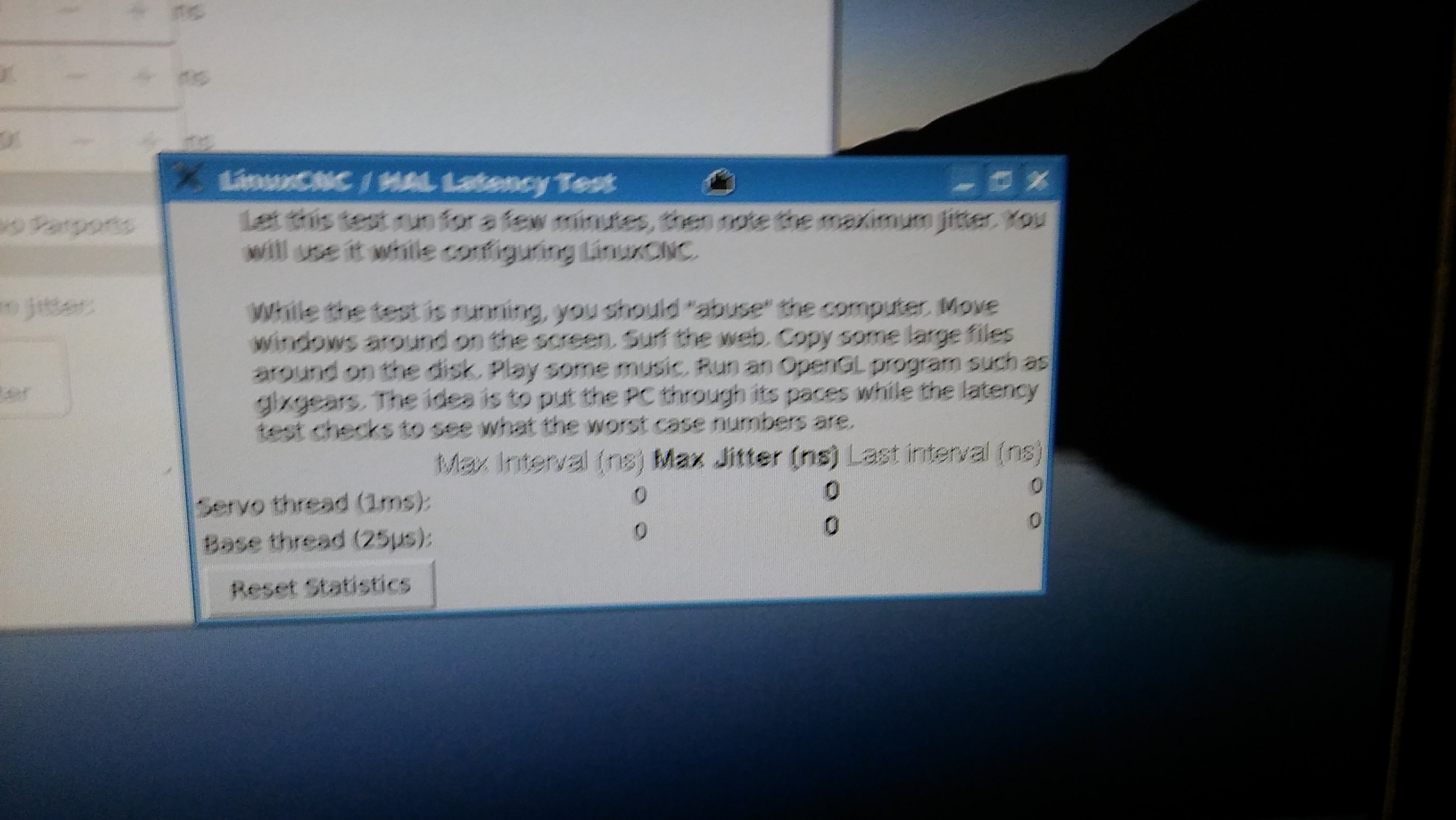

- clifo
- Posts: 7
08 Apr 2021 23:52 #205393
by clifo
Cannot run after restart.
- twoflowers
- Visitor
10 Apr 2021 09:43 #205527
by twoflowers
Ok, I found it. Looks like refracta breaks linuxcnc (RTAI) - but I have not found what exactly breaks. So in the meantime this is a workaround - you need working internet for this:
Boot from ISO and open a terminal.
$ sudo apt update
$ sudo apt reinstall linuxcnc
$ latency-testPlease Log in or Create an account to join the conversation.
- clifo
- Posts: 7
11 Apr 2021 03:47 - 11 Apr 2021 04:34 #205615
by clifo
After reinstallation LCNC it works.
After adding "isolcpus = 2.3" to the GRUB PC freezes, only a hard reset will help.
MB: J3455M, 8Gb RAM, SSD 120Gb
