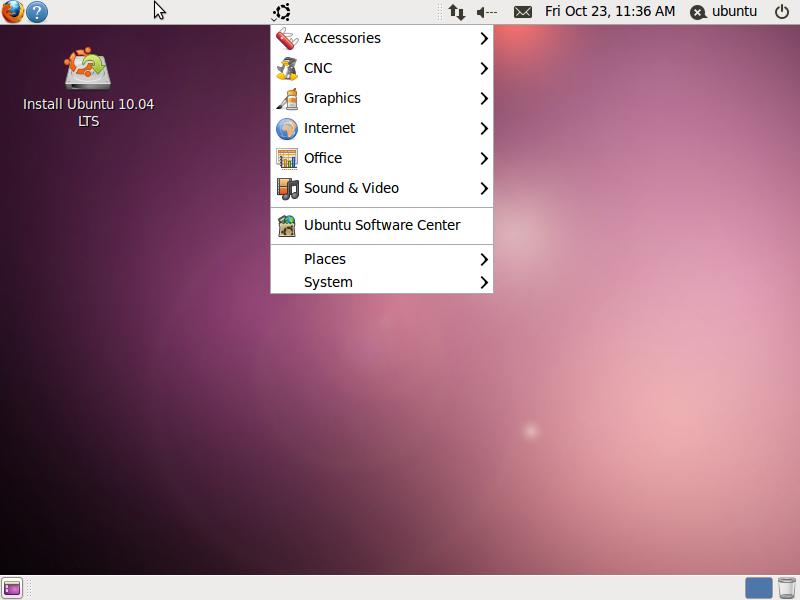

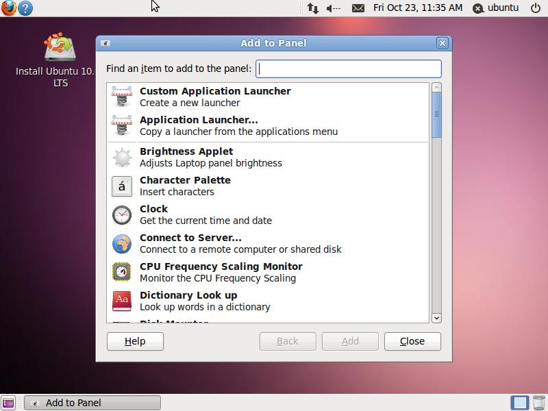

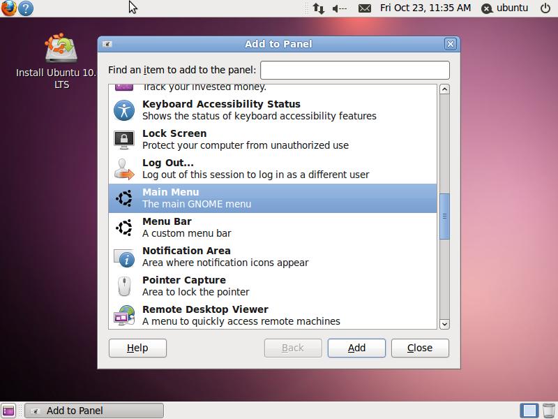

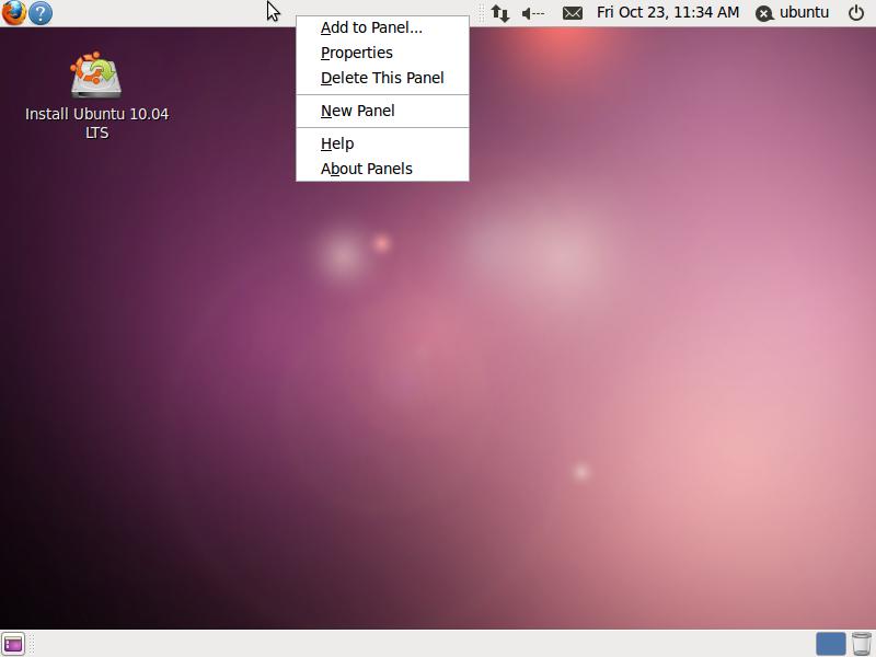

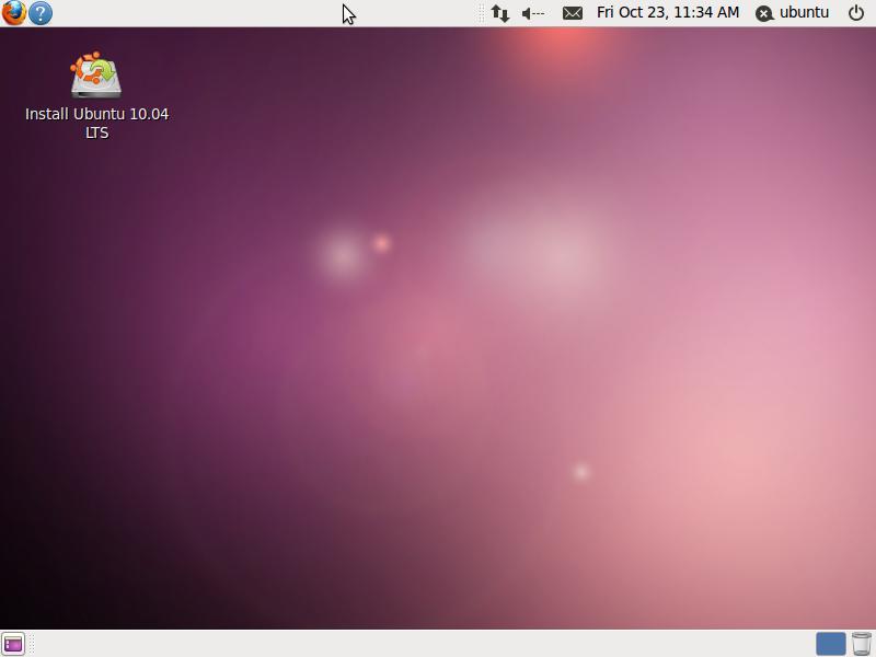

So m problem is exactly that I need to add 4-tx axis to my machine configuration.
I tried to do that by editing ini and hal files but that did not work as I got errors and nothing working in the end.
So I thought I will use setup config wizard, as I did in the beginning but I found out that I have no "applications" list/menu on the top bar, and than I noticed that this bar looks different than before crash.
So either
I need to edit config files for my machine to define 4-th axis (had read manual related to ini and hal files but did not succeed to edit this files correctly),
or
I need to launch config wizard (do not know how to do that not having applications menu),
or
I need to fix mu GUI (gnome) to have applications on the top bar back ( so to launch config wizard).
Cris.

02 Nov 2020 13:37 #188138
by kmeld
Replied by kmeld on topic linux cnc on an old computer - plaese advice
This worked.
I have managed to configure 4-th axis.
sort off.
Still missing jog key shortcuts.
Cris.
