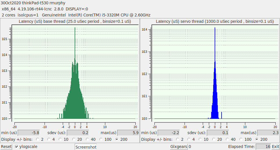

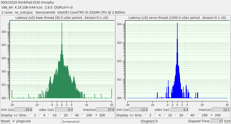

29 Oct 2020 15:17 - 29 Oct 2020 15:22 #187717 by BeagleBrainz
Replied by BeagleBrainz on topic Debian buster installation with 32-bit RTAI Source
Here's a sample quick test of my T530 with wifi on with a 35000 base thread. With Firefox open whilst reading this thread.
Not really a full test but it goes to show that a lesser spec machine can give better results.
This is with the same kernel that I supply on the Mint 19.2 Linuxcnc ISO the 19.3 ISO has a slightly later version on the RT_PREEMPT patch. Just for completeness the BIOS options have been set to the lowest power saving options.
Same machine with CPU #1 isolated

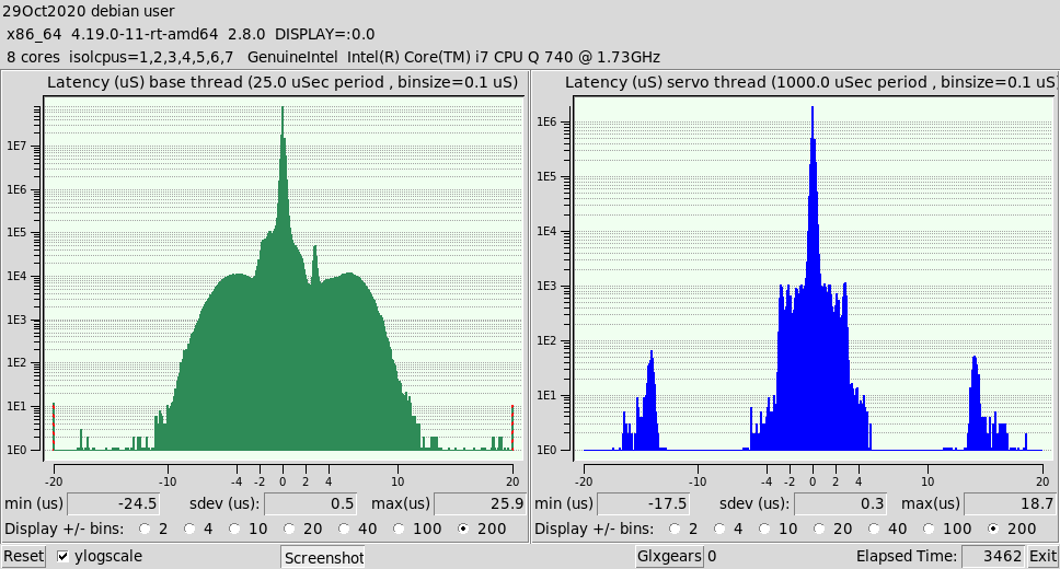

29 Oct 2020 17:34 - 30 Oct 2020 12:08 #187730 by Vescovo
When the CPU is isolated , the ISR is entered more reliably because the time to swap CPU does not have to be added? You obtained 1/2 sdev with a shorter base period and 1/4 sdev for the servo period. It makes sense. The Max Min numbers you are getting with a single cpu are quite acceptable in my view. What is your opinion?
Do you know if the interrupt to the ISR is routed through the APCI or is it direct? Depending on the hardware design irq3 and irq4 may get you into the ISR more quickly.
The processor can be disabled in the Live LinuxCNC 2.8 buster ISO by editing the Grub at boot and adding "isolcpus=1,2,3,4,5,6,7" where quiet and splash are shown from the in the menu.
This image is running on the I7-740 with wireless disabled and 1 processor enabled
This image is running on the I7-740 with wireless disabled and all 8 processor enabled

29 Oct 2020 18:40 #187736 by BeagleBrainz
At a pinch even the non isolated cpu boot could be used.
I'm not a kernel dev, and to be honest haven't looked at IRQ routing under Linux.
Minds much much greater than mine have decided that the current way Linuxcnc is the way to go. Other minds have forked Linuxcnc to the MachineKit project.
Basically what I was trying to illustrate is that CPU speed is not a great indicator of Jitter & Latency figures. Many users have had good results with mini ITX boards with J33xx series celerons.
